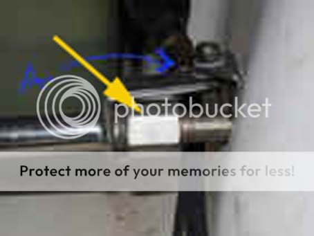

If to much play in the steering is encountered this nut can be the source as well. Image
The steering piston should not have any longitudenal play in the tubing.
Especeally this can happen after exchange of the steering cable. (As it happened to me :| )
After ending up multiple times with "Autolearn fail 1" during the auto steering sea trials
I became aware of this. :o

2BonC wrote:If to much play in the steering is encountered this nut can be the source as well.
windypatrick I hope You don´t mind me steeling Your picture :wink:
rainer
LOL! Just check on Sumner's yellow arrow! :D , you are right, this is an overlooked area, cable movement thrust has to have a reaction surface. 8)
