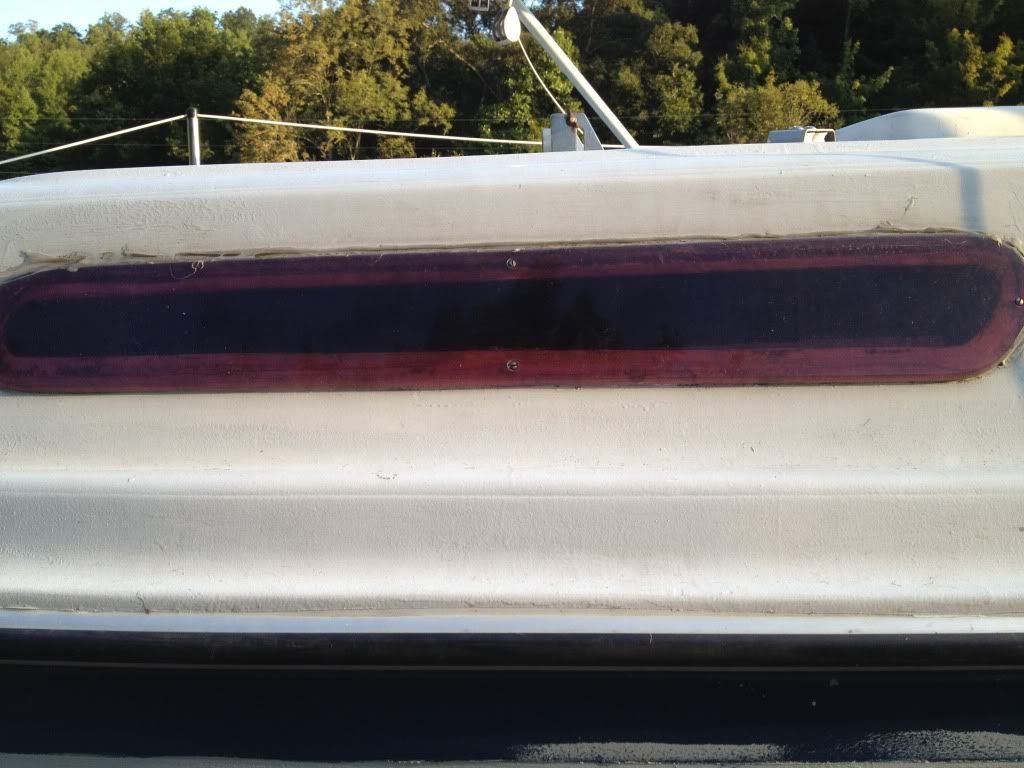

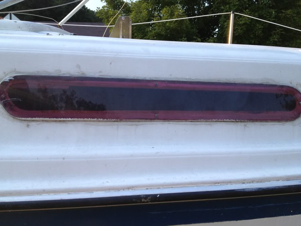

Hey folks, got another question about my elderly M25. The PO unfortunately did something...weird with the cabin windows.Image
I don't know how much you can see from the pictures. There's no trim around the windows; I've seen other M25's that had trim; did all have trim? He caulked the windows with a fairly heavy and rather irregular hand. Not completely sure where to go from here; can one get trim to put around the windows? Are replacement windows/trim available?

I don't believe the MacGregor 25 ever came with trim on the windows from the factory.
I think what has happened here is that the owner had some sort of leaking around the windows and to fix it, instead of removing and re-seating the windows he just smeared sealant all around them.
The proper fix would be to strip off all that goop, remove the windows VERY carefully (they crack *super* easily) and re-seat them with proper sealant. If you want replacement windows I think your only possible source would be be Blue Water Yachts, and I'm not even sure they'd have them. Failing that, you could make your own if you've got talent - if not, go to a glass shop and see if they can make some out of smoked Lexan.

What would be the right sealant to use if I did take the windows off and reseat them?

You can seat them with GE's Silproof SCS 2000 or Dow 795 structural adhesive (the latter is what MacGregor recommends, and Boeing uses it to hold in the windows in their jets). Use only enough to seat the window and have a SLIGHT bit squeeze out, which can then be wiped off and smoothed with a wetted finger. Be *very* careful to screw the window on a little at a time, tightening the screws in a circular pattern in small increments to prevent over-stressing any particular screw hole. Also, the screws do not have to be terribly tight - the sealant actually holds the windows on, not the screws - they're mostly there to keep it in place while it's curing. Make sure you dab a small bit of sealant under each screw head before installing them so they don't leak.
Below is a link to a thread where I explained in excruciating detail how to replace a window.... hopefully it's helpful. I used 3M 5200 when I did my window replacement, but that's not the recommended sealant. That being said, it has held up nicely on my boat.
