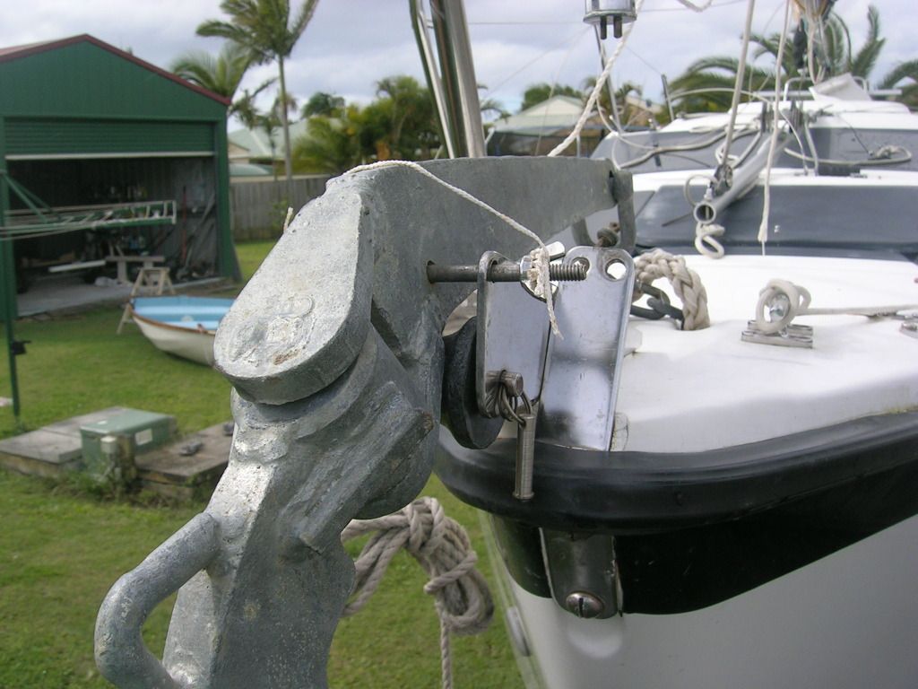

Does anybody have a close up picture of their forestay attachment to the bow? I got an anchor roller on there and I'm not exactly sure where to connect to forestay. I believe I remember that there is a plate attached to the anchor roller with 2 holes. I assume the forestay goes either on the left or right and the jib halyard connects to the other one. The manual doesn't match what's on my 26M.

But I think you've got it right. I have a furler, but the forestay pins through one of the holes on the bow roller. I don't use the other one, but if you have a hank on jib, that would be the place to attach it.

The anchor roller is seperate. I have a furler and attach it to the port side hole, to keep the drum a little further away from the roller, but would probably put it to the starboard with no furler. I doubt it matters really..

Thanks for the pics, looks like I've done it right. I also spent about 2 hours scratching my head looking for a backstay while bringing up the mast (heavy sunburn and freaking out about the mast falling forward).

The lack of backstay took me a while to get used to. I do like not having one in the way. Seems like magic when the shrouds tighten up and the mast is upright.
