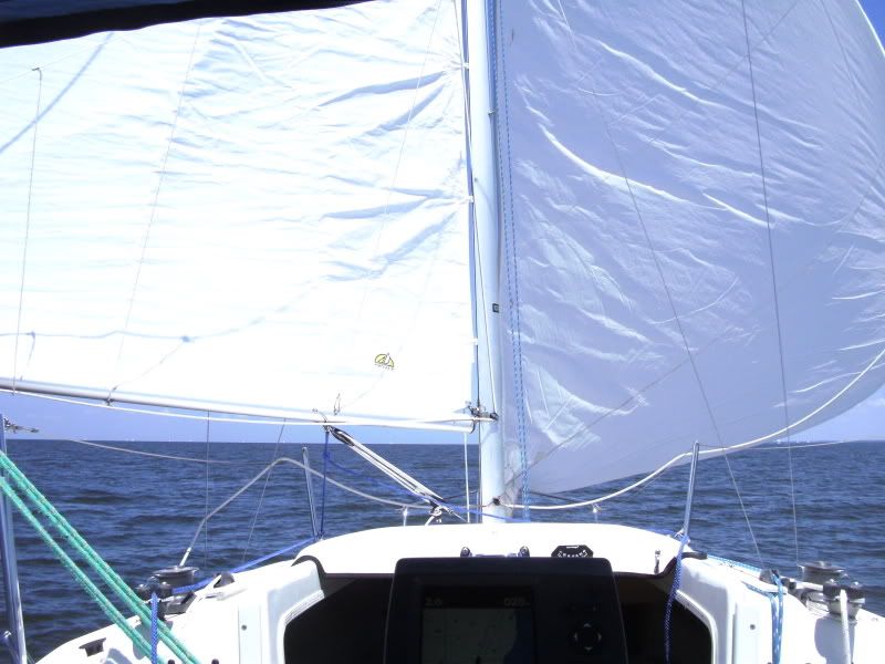

I have single-line reefing. It starts at the front port side of the cockpit and goes through a jam-cleat (you can see the black jam-cleat just to the right of port winch). The line runs forward and hits a turning block abeam of the mast and takes a 90 degree turn towards the mast. It goes through another spring-loaded turning block mounted on the deck right next to the mast (it is literally screwed into the deck) which turns it 90 degrees up the mast. From this turning block it runs up along the mast/sail to the stock reefing cringle in my main. Then through the cringle and down the other side to a turning block screwed into the mast on the starboard side right next to the goose neck (you can see this block in the picture). This block turns the line aft along the boom to a turning block screwed into the boom which turns it back up to the aft reefing cringle. From this cringle the line runs aft/down to the back port side of the boom where it is tied off.
If I reef while under way I normally "heave to" first. Once the "heave to" is working the main is fairly slack. I release the main halyard (from the front starboard side of cockpit) and lower the main about 10'. Then I grab the working end of the single-line reefing on the front port side of the cockpit and start pulling it in. Eventually the front cringle will be pulled down as low as it can go. But I normally can still pull another few feet to get the aft cringle to go as low as I can get it by pulling it in. If I can, I help it out by physically pulling the aft end of the sail down but this is not always possible. It is key to make sure the halyard is pretty slack when I am doing this.
Once I have the reefing line as far in as I can pull it I tie it off. Then slacken up the boom-vang and rehauld the main back up. This normally works pretty well for me...and I do all of this solo.
Having the reefing line run through blocks attached to the cringles as Sum has done would probably make it run a little easier. But I have never really had a problem so I have never take the extra step to use those types of blocks.
This is definitely a good mod for a single-hander. I have probably reefed 30-50 times.
Sailing on König
On Edit: Found another picture which shows the two turning blocks for the reefing line on the port sidel.
