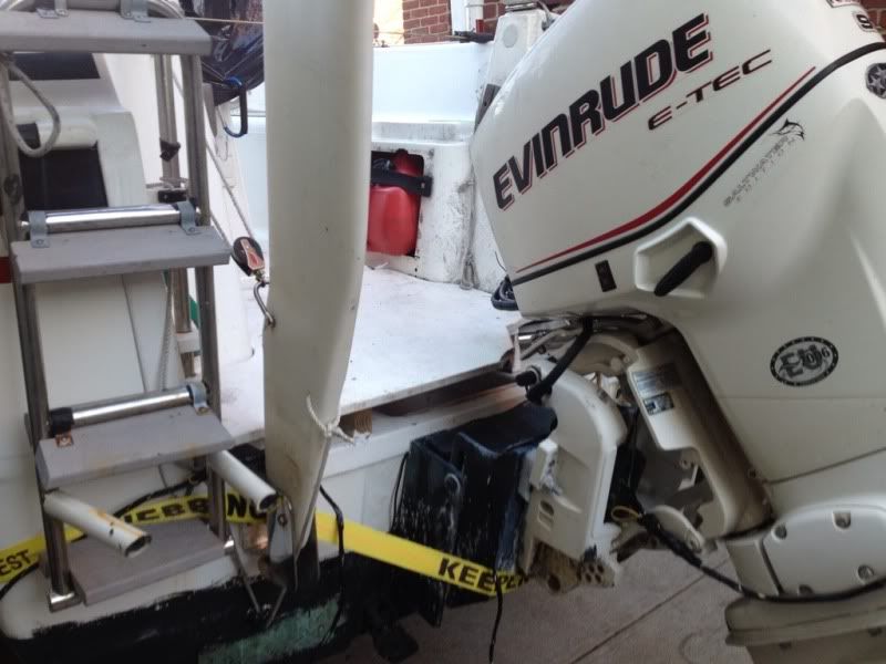

Here is what I use, and I am always amazed at the difference in opinions when it comes to tying down the Mac to its trailer.
I also secure at the bow.
I did not always secure when trailering, when I first bought the boat, I mentioned on this site that I did not secure the boat. A post from Kevin opened my eyes :o . It makes sense to secure the boat to the trailer. This big, yellow, bad boy does the job. :D

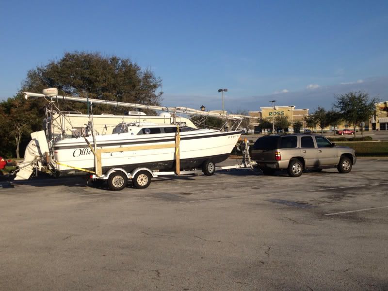

When I'm traveling far, >50 miles, it's 2-3 straps that Ray highlighted. But I have my reasons.
I overhauled my trailer this Spring. [SS Tandem disc brakes, new 2x8 pressure treated bunks, paint] & I put on those plastic strips that can let you slide your boat off for loading and unloading - and possibly driving :| They do work. I can push, hard against my boat, sideways and center it midst the trailer.
So it's one butted along the transom line to keep her on the trailer - should the bow eye or winch fail. [I'm thinking more winch- next mod]
And one forward of the lifeline stanchions wrapped and in line with my 2x6 guides, forward and aft vertical supports. You can sort of see the yellow as they cross the vertical braces that I bolted to spare tire guides :wink:
I just did 3000 miles Competent, Confident ...
& Snug as a Bug 8)
