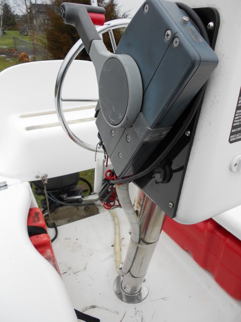

I've got the Yamaha 50 on my :macm: . This is what the PO had installed:
This is not what you want! Because the unit didn't fit in the pedestal the throttle cables run down the hose on the side and then out through the back. Very ugly and annoying. Works fine but I hate having that hose on the floor.

here is a photo of my Yamaha 60 throttleImage
