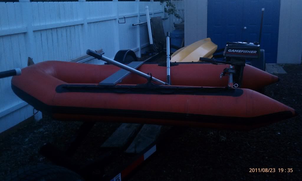

I just purchased a Dinghy for $200. I have a 3hp motor that runs well, the dinghy is 9' tip to tip or 8' bow to transom....With a wooden floor ...I have a 3hp that runs good Is this enough?
HP rating on plate is 10HP max...Should I look for a larger motor? I want to use it to explore coves and buzz around to different local areas where the Mac can not go...
Never owned a dinghy before so no prior expierience..

I'm currently running a 1.75 Gamefisher. I've had it forever, but I only need to kick around 99% of the time. If you want to get on plane you'll need more. I'm not sure what that would take, so the replies here hold my interest as well. I'm sure more hp would be more fun to tour with. :macm:

The 3 HP is really light -25 lbs and is air cooled, Budget is a consideration I really do not want to drop $1000. on a new motor. I may wait out the winter stalking craigs list to find something larger. I may have found a Evinrude 7.5 that runs for $350. but it is about a 2 hour drive one way and not sure I want to make the drive for it. I will update this post once I get it out on the water with some results
Dave just curious ...Why would the Suzuki 2.5hp run circles around a 3hp?
Mastreb...not ready to sell just yet but I did put a new carb and fuelbulb on it so I know parts are still available
Russ... I fired it up in a water filled can and it was not terribly lound but who knows once you get out there
