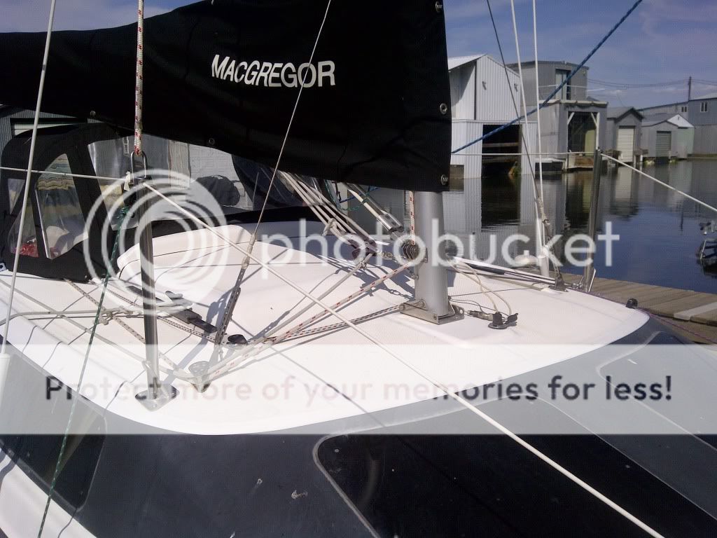

So, I have rope pulley boom vang..which I am guessing is the standard set-up since this boat is nothing but basic. The line leads back to the aft and can go through a "clutch" (I think that is the term...it's a little box that the line passes through and can be clamped or released) The problem, and question, revolve around the fact that the line passes through a "clam cam stopper" (so beat me if I am using wrong term) that locks the line but at the mast...and in order to release the clam you have to climb up to the mast ...is this right? I am guessing not and think since the clutch is there and easy to get to I could remove the clam at the vang and have the ability to release and adjust from the helm.

A picture of what you have would be great! You should set it up so that you do not have to go to the mast to release it. Put only a block and tackle up under the boom (two double pullys), with the final line leading back to some sort of cleat that can grip the rope and you can reach from the cockpit.

I have the same setup that you do, so I will venture a guess that your boat was a BWY boat? On the starboard side of the foot of the mast, I have two blocks and over by the stanchion, another two. The mainsail halyard goes through one half of these and the boomvang the other. Both lines then come back to the cockpit on the starboard side; the halyard to the starboard winch and camcleat, the boomvang through a rope clutch. This effectively bypasses the camcleat on the boomvang. I will provide pictures the next time I'm down at my boat.
