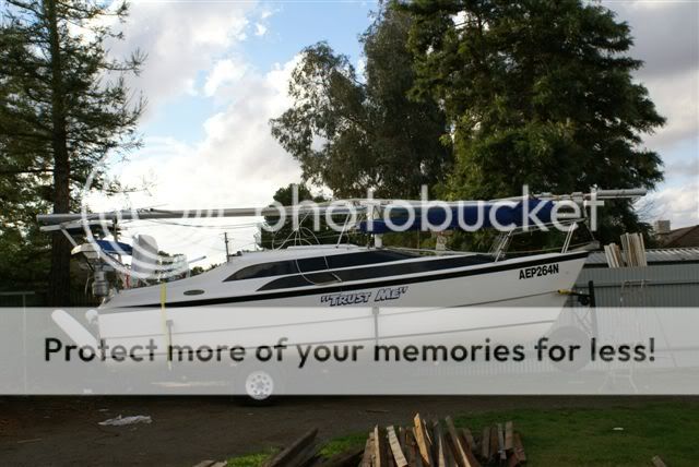

Boblee
- Posts: 1702
Re: Solar Panel at the Rear Mast Carrier
This picture shows how I did ours by making a new higher and stronger multi purpose arch assembly for 2x65w but you could just put a brace off the existing arch, although you would probably need to remove the panels when trailering due to stability especially for long journeys.

Boblee
- Posts: 1702
Yeah looks pretty strong oskar surprised at the weight using stainless and thats why I used Alum but I suppose by using the solar panels as cross bracing it would firm it up and you wouldn't need the extra material, wouldn't hold my dinghy though as it's about 250 kg +.

Boblee
My dinghy only weighs about 32 kg. The stainless davits did not weigh all that much - about 4kg each. The strength comes from the double cross-braced tubes and the SS wire braces which also help distribute the load. Although the davits, panels and dinghy have had no problems at sea, or from high winds in my mast-up storage area, I don't think I'd like to leave them in place when towing on outback roads.
I saw the forces generated by passing road-trains and from bouncing over rough roads on my Shark Bay trip when I had the panels arranged as "bat wings" on SS rods between the cabin stanchions http://www.macgregorsailors.com/forum/v ... 15#p164489. Quite scary at times!
I think your aluminium set-up would be much better for towing long distances on rough roads.

Boblee
- Posts: 1702
Yeah that looks great Oskar only thing I would do would perhaps be to bolt the two sides together at the rear for stability, great being able to turn them sideways providing the boat isn't dancing around of course, our arch is fairly multi purpose as a carrier for the aerials and gps receiver, horn, rear light, boat hook, handhold, extended and extendable mast support but now remove solar panels when travelling long distances at least
LOL the road trains talking to a barman in central QLD about Mexicans (Vics) and their attitude and he said "ah the road trains usually quiten them down a bit by the time they get here" they amaze me at the bottom of QLD they are on a goat track wide enough for one vehicle and they see a road train coming with the rear trailer swaying up to 3' under normal conditions and they TRY to stick to the middle of the road trying not to get their caravan dirty?????
How they think those rigs are going to get off the road for them defies belief.
We got a windscreen broken pulled up 25 M off the Barkley Highway (one vehicle wide bit of broken and very potholed bitumen, or corrugated dirt) when one went past and think thats how I lost two solar panels when I didn't get off far enough for one and forgot to put the retaining pin though but it was 500 k's of terrible roads so wasn't going back to check thats for sure.
