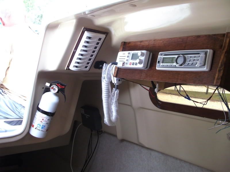

I installed my VHF radio and Stereo in a wooden box above the galley on the port side.
My Dad actually built the box for me. It probably could have been made a little bit smaller. It is secured via two bolts which actually go through the deck. All you can see on the deck is two bolt heads and washers. And they are sealed with silcone sealant. The antenna cable runs through a hole drilled in the liner behind the box to the back of the boat and then down to the area below the aft bunk then out the back through the same hole that all the engine cables run out. Then up the mast arch to my antenna mounted on the arch.
The pros of this set-up is that I don't have to run power cables very far or across the boat. The cons is the speakers. I still don't have the speakers installed. I have them wired up but they just sit in the cabin. I haven't figured out how I will run the speaker wires yet so they just lay out in plane sight...they come out of the back of the wooden box (which does have a bottom screwed in so you can't see those wires...but it has no back right now). Maybe what I need to do is get really long speaker wires and run them aft and then cross over to the other side in the rear of the aft bunk then up to the liner and then forward on the starboard side behind the liner...is there a problem if speaker wires get really long? I am not sure about that.
My stereo is made by Dual and has a USB plug so I can hook up my iPod and play all my iPod tunes. It has a remote control which I can use from the cockpit.
Don't have a remote mic for the VHF...but to be honest I don't use my VHF hardly at all. But if I do I can sit in the entry way and keep my head out looking around while talking.
I don't cook on my galley so no issues with the box getting in the way. But even if I did the box would not be in my way. I leave the galley full aft most all the time and only use the aft bunk for storage of "stuff".
You can see the computer and wires for my wheel pilot...but when the galley is aft this is pretty well hidden.
Anyway, it works for me. I have seen some others with some really neat set-ups...I am sure they will post pictures soon. Or you can do some searches and find them.
