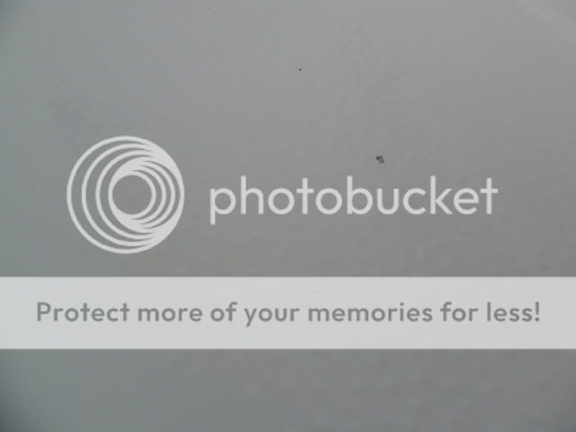

Just noticed the Gelcoat Blisters in the anchor well. Had a piece of carpet in there to protect the gelcoat from the anchor. Reckon that with the rain we had, fresh water sat in there on the wet carpet.
Have taken out the carpet, also had some carpet under the fuel tanks which has now been taken out as water lies on one side under fuel tank.
Hard to see photo, however here it is...

DaveB .. Yes as from your pictures.. when I think of blister issues? THAT is what I envision.. Not the pin pops ( smaller than the head of a straight pin, less than 3/32's of an inch in diameter) I see on mine or other Mac boats .. Yes mine should be repaired.. However IMHO if they are not and the F.G lay up is proper that F.G is not going to degrade as shown.. Our Gel Coat is porous..
Why might we have the pops? Tiny voids ( during fabrication.. so much as a speck of dust ) between the F.G. and the gel coat.. Gel coat is porous and water travels through to the epoxy and is there by trapped between those two layers. One issue or another causes expansion and POP! or pin bump..
With close to, if not more than 10,000 of these boats plying the waters of the world.... I have yet to hear of what I think of as blister issues with any of these boats..
