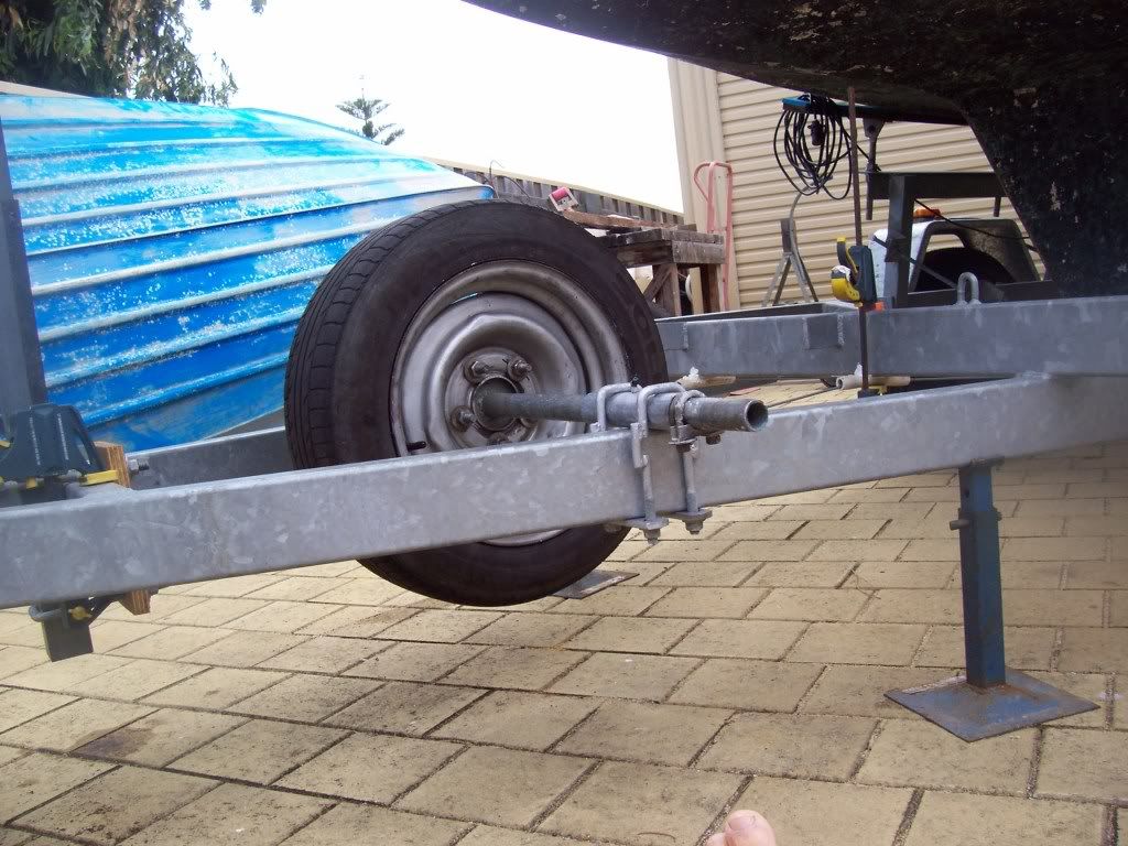

Hi Patrick...Could not help myself when I saw your new trailer...nice but a bit incomplete...
And where is the rear support for you mast...without one the mast will flex up and down too much...or maybe it was not stood up when the pic was taken?
the rear guide posts are good but how do you control any sideways drift of the bow in any sort of wind or tide?
Do you have any plans for side ropes or PVC pipe to control the bow? Many
owners have fitted these. Of various plans but they all do the same job...to 'contain' the bow right up to the "V".
And have you considered a third 'roller' wheel [ not a 'jockey' wheel that raises and lowers] but a full size wheel fixed in line with the tandems...so the whole trailer can be disconnected from the towing vehicle and it can be rolled much further down into deeper water...if needed...
When the trailer is off the truck, the tow bar lowers and the wheel is operational...and the whole rig travels in a straight line down the ramp controlled by a 20 ft. cable from truck to trailer...or longer if needed...

Crikey... is that a Girling master cylinder I see on there!!??puggsy wrote:
