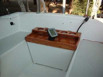

I prefer to keep my fuel tank in the cockpit on my 26S. Many have built nice tank covers with storage compartments and cup holders etc., I like the design of the one below, but I've seen many different designs.
