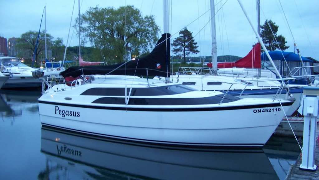

Hello
my .02
I am slipped in fresh water from May to Oct every year. I had a sandpiper sailboat for 10 years before I got my M. I never painted my small sailboat and had nothing but problems from start to finish with the bottom. It was a 1977 model and was in bad shape when I bought it, so I just kept the thinking that it was an interim boat only and was not worth $$$ to fix it up as I only paid 2700 for the boat, motor and trailer.
With my M, I wanted to keep it looking like new but did not know if paint was the only option. I tried no paint season 1. Bad idea. I tried anti fowling wax season 2, did not work. Tried Interlux VC17M last season, fantastic results.
I asked around my marina and that is what everyone with far larger and more expensive boats of all types were using.
So I bought it, followed the instructions, ie sanded, cleaned, and applied 2 coats the first year, and 1 coat after that.
Goes on fast and simple.
No mess.
No fuss.
I chose to put 1.5" painters tape along the bottom edge of the black stripe as I knew where the waterline was and wanted to preserve the look of the white/black/white.
