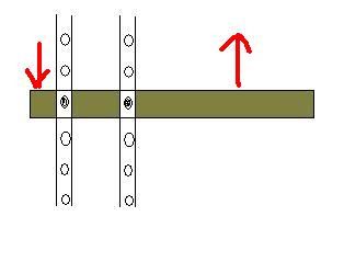

There is nothing like simple. Your idea is perfect. Many of us M owners have a backstay that would do the trick.
When I bought my boat at BWY, they showed me this tool.
Ray joked how easy it was to make one, but for those too lazy to do so, they also sell them. He showed me how you simply put the "screws" in the holes of the adjacent stays and apply pressure to allow the pins to be removed and moved to the next hole.

I don't have one, but the distance would be approx the distance between shroud turnbuckles.bubba wrote:What is the dimension between the bolts ? on the oak wood tool.
I'm a terrible artists, but you insert the bolts in the two shroud turnbuckles and use the leverage from the off of one to tighten the other.

..so slightly LARGER than the shroud hole spacing between the plates, of course....

If you do make one of those just be sure you use a dense hardwood or metal. Don't use a softwood like pine. I threw one together with a scrap piece of lumber and it was worthless. I went ahead and made the tool from a welder's vice grips.
