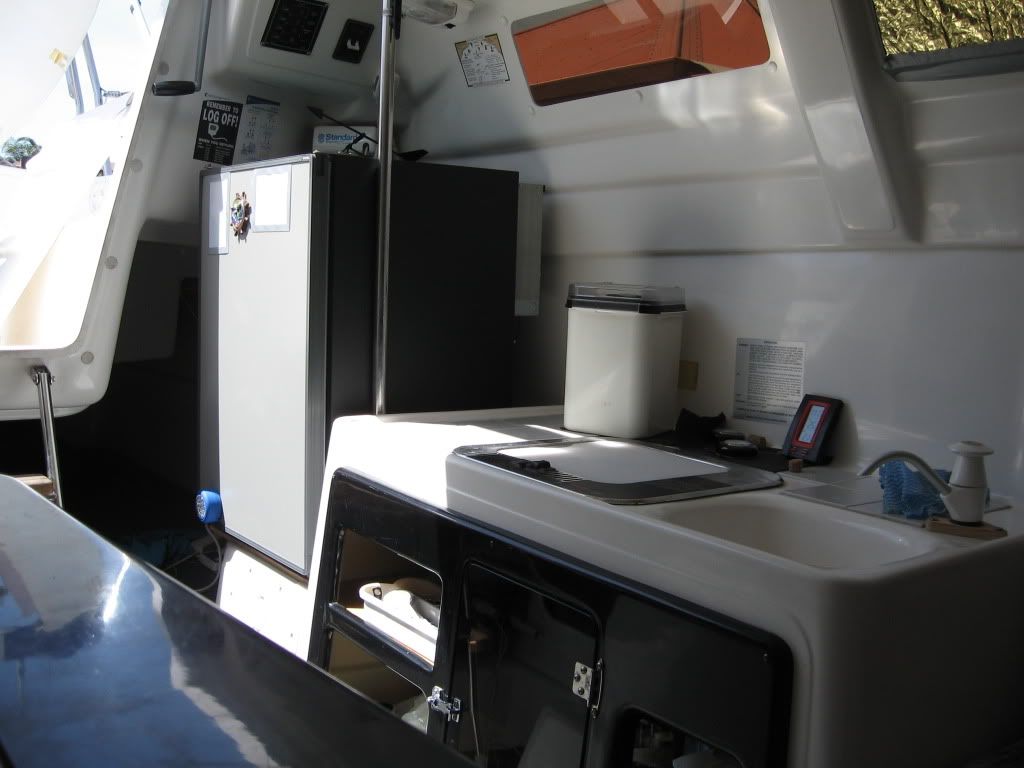

I tried putting a engel in the cooler liner and under the table but accessing it was a pain so i sold the 40 chest and bought a 80lt upright and did this
The door opens from the rear and clears the ladder and getting a drink from the cockpit is quick and easy.
The laptop sits on top and is viewable from the cockpit.
I did this first with a 55lt but it was too small and the 80 has a better freezer compartment.

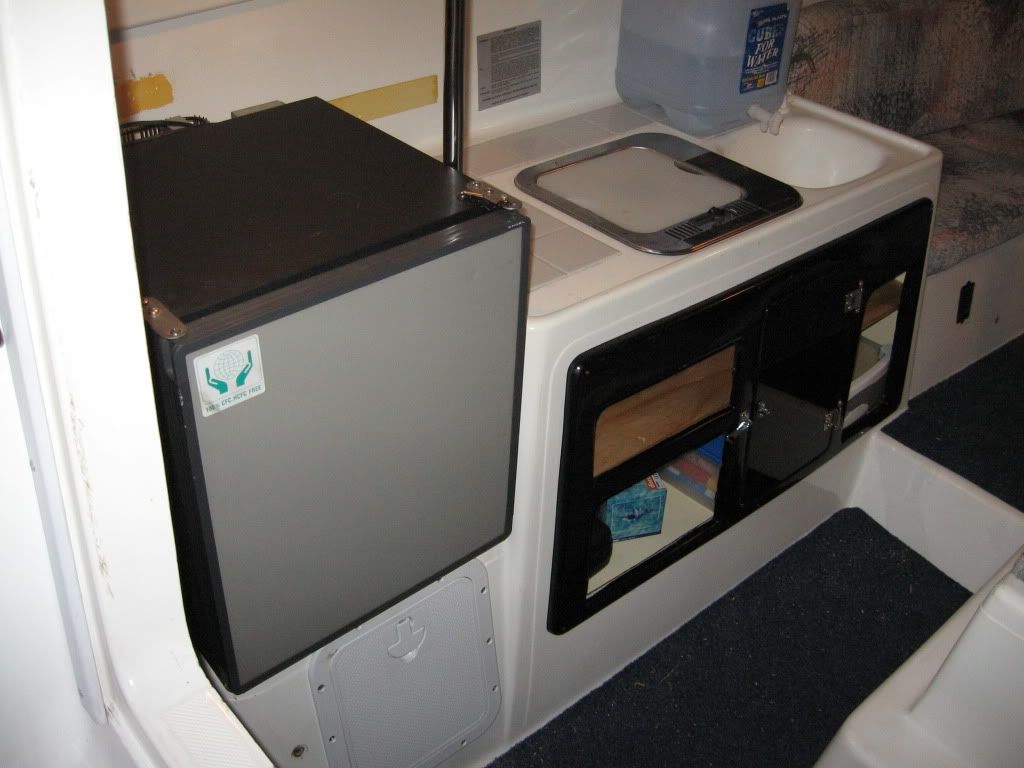

Getting back to Ref. I went to Lowes and bought a grey rubber backing carpet for the cabin Sole . Pd $.50 a sq ft. and doesn't unravel.
Put this under the new Ref. and took off the 4 legs on the ref. and put on 1 inch wide self stick 3/8 thick rubber.
I will use carpet tape to keep it in place so the ref. doesn't slide around. Also putting two eyes that I will attach to liner with rivits on each side of frig. and will secure the unit to these with 3/16 inch braded line. I also put in 4 screws mounting the access wood panel below the ref.
Takeing pictures tomorrow.

I spent all weekend cutting carpet for boat and fitting Refig. in place.
I bought a 12ft.X51 inch cut off roll of rubber backing Interior and exterior carpet @.50 a ft. Cost $ 28 and had enough left over to do walkways in cabin again plus carpet pads for stern.
I will use double carpet tape under Refig. carpet and snaps on the forward walk.
