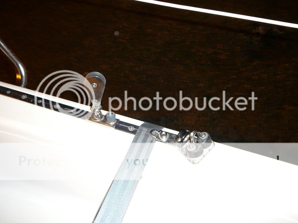

I think that we are talking about "Almost Standard Macs", which yours has gone a wee bit beyond, J.

The car in your picture is almost like the factory jib cars I have. For the roof tracks.
Factory genny cars are much less restricted in their movement, the block is "spring" loaded. (The tall one in Hamin'X's picture).
Your jib car will work as a genny car, but the limited swiveling will not allow the different angles the genny sheet needs to take to get from the sail to the block, then out and forward to the winch.
Hence the extra articulation is needed.
If you don't get a "real" genny car, no big deal. The sheet will just not track perfectly into and out of the block causing perhaps a little more wear.
If you still want to get a "genny" car, IMHO, and as others have opined above, get the EZCleat style (the smaller one in Hamin'x picture) and kill many birds with one stone.
