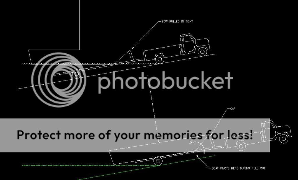

I can explain the Mac bump problems. For 8 years, I did the Mac bump with no problem. I had gel coat - no bottom paint. This year, I put barrier coat and Hydorcoat ablative bottom paint on. The boat and trailer will NO LONGER do the Mac bump! I had all wheels locked up and the boat would not slide on the trailer. I put on a bunk slide product called "Liquid Rollers." It now slides a bit but it is too difficult to do safely. I prefer some other solution than the Mac bump.
The reason there is a gap is because, on loading, the angle of the trailer and the angle of the boat are different. The winch and rubber V block are on a lever arm and a trailer in deep water levers the rubber "V" block farther out. The deeper the ramp, the greater the diference in the angles, the more the rubber V is levered out, and the more the gap will be. That's why cranking as you pull out helps reduce the gap. As you pull out, the angle of the boat and the tailer become the same.
I think the big problem with the trailer (I have a 26x) is the front V bunk. If that were rollers somehow, or something more slippery, you could more easily crank it up as you pull out. I reach a limit where I can't crank it up any further and a gap remains. That may be a problem with the winch position.
A solution might be the suggestions mentioned in this thread. Replace the rubber V with a roller and change the winch position.

My old V22 has the same problem.
I recall a discussion about the winch not being strong enough with a picture of the winch being pulled away from the mount on the trailer. I believe the problem there is that if you winch the boat up tight and then pull up the ramp, the boat is pivoting on that front bunk, and putting tremendous force on the winch. This force could easily be much more then the entire weight of the boat. The boat being a lever and the front bunk being the fulcrum. You know that saying "Give me and long enough lever and I can move..." Looks like you have a 26' lever with a 300 pound weight on the end. I would guess that if everything was ridged you would pull the boat out and find the back end of the boat off its bunk. But there is enough flex and give in the trailer and winch strap to allow the back of the boat to land on the bunks.

Where you been all our lives? This is your first post??? It is MOST INTELLIGENT!! Please post more often!wlcenterville wrote:I can explain the Mac bump problems. For 8 years, I did the Mac bump with no problem. I had gel coat - no bottom paint. This year, I put barrier coat and Hydorcoat ablative bottom paint on. The boat and trailer will NO LONGER do the Mac bump! I had all wheels locked up and the boat would not slide on the trailer. I put on a bunk slide product called "Liquid Rollers." It now slides a bit but it is too difficult to do safely. I prefer some other solution than the Mac bump.

That is because the winch is below the bow eye. As the boat settles, the bow eye pulls up on the wench. If the wench were above the bow eye, the boat settling would not put additional stress on the wench or the mount.I believe the problem there is that if you winch the boat up tight and then pull up the ramp, the boat is pivoting on that front bunk, and putting tremendous force on the winch. This force could easily be much more then the entire weight of the boat.
I put a roller just forward of the front vee bunk. When loading the boat rides on the roller until I'm almost out of the water and then it settles onto the bunk. This does not help with the gap and still requires a "bump".

Solution for me: Removed the winch turned it over and mounted it on backside of original location. Drilled a hole and led rope (cable or strap) through to hook. Now winch is pulling up not down on the boat. Has worked for 10 years no mac-bump bs. Cost, I think I bought a drill bit.

hi all mac bumbers i have abanded the bumb for just putting a fair bit of pressure with the winch . on a 20 minute drive from ramp to home i stop 2 to3 times and re tension the winch, i find the x slides foward to fit securely in vee rubber. the x is being carried on a 2 axle trailer not sure if that helps. regards uncle trev

Anyone have a picture of a winch mod that works????? I put a new one on last year and it stripped the gears right away (thank God the first thing I did was place a saftey chain), not sure what way it originally sat since the previous owner was a mod machine!

A quick search of the Mac Mods, using the search term "winch" and under the Trailer category reveals:Snyds wrote:Anyone have a picture of a winch mod that works????? I put a new one on last year and it stripped the gears right away (thank God the first thing I did was place a saftey chain), not sure what way it originally sat since the previous owner was a mod machine!
Thanks as always!
Steve
Relocate Trailer Winch, by Tahoe Jack. Although in the mod Jack uses a new winch, you can reuse the existing winch, the handle will just crank backwards.
