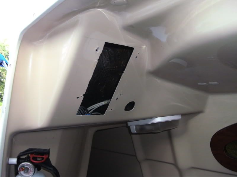

New electrical panel hole
Electrical panel with wooden frame...as well as the box mounted VHF and Stereo. Box is probably a little too big.

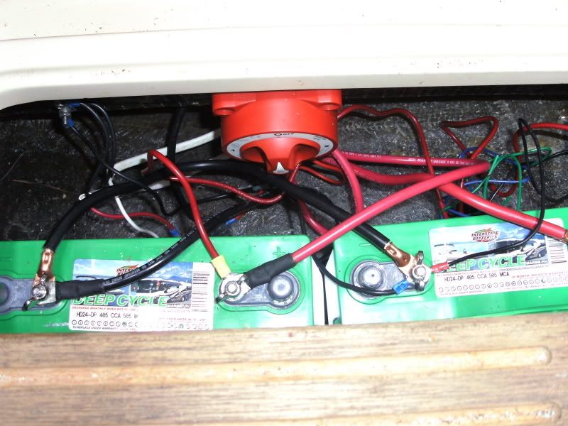

New dual battery system with new 1-2-Both-Off Switch.

Those open terminals on the battery scare me. The one fire I've heard about on a Mac was caused by shorted open battery terminals. For a few bucks you can get some caps that will protect the terminals from any loose metal objects that could find their way to that compartment. The caps are the next best thing to a dedicated battery box.

The Neg & Positive are very close, If not the terminal hoods/covers rotate one battery 180 degrees so the same polarity terminals (NEG terminals) are side by side.
It will reduce the possibility of shorting them with a tool or other metal object.

Thanks guys. Good advice. I will look for those boots...auto parts stores sell those????

You will probably get a set of boots from a motorcar type chainstore,dont know what they are called stateside,over here it halfords.
Re: Completed install of Electrical Panel, VHF and Stereo
Got mine at West Marine, no doubt overpriced, but still pretty cheap.
http://www.westmarine.com/webapp/wcs/st ... assNum=297
What's nice about these is they are made for the wing nut type terminals instead of the automotive style terminals. They give plenty of space for a number of wires.

My Interstate batteries have both big automotive style studs and wing nut terminals for both pos and neg. Do I need a different type of boot?
