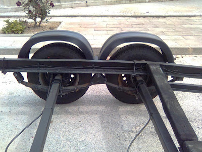

I don't know the exact words in English but a double axle is important to be "articulated"...
Mi system is a triangular one (there is another with an horizontal lever).
It is important because it creates a kind of dynamic center of gravity that avoids big lever forces on the tongue when passing irregular ground, breaking hard, blowing a tire, etc...
If one wheel goes down the other will gently go up...
When breaking they all go down...
That gives a lot of stability to a trailer.
Adding a second axle without it... Is not a very good idea...
