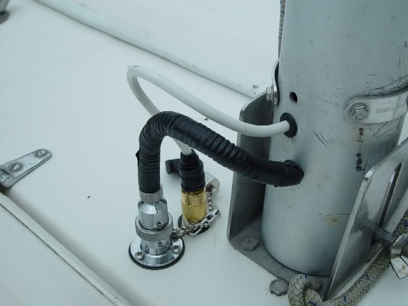

I used this type connector from West Marine:
http://www.westmarine.com/webapp/wcs/st ... assNum=316
I have two mast lights so I used the 4-pin one.
Here's a photo of it:
The other connector is a UHF connector for a VHF antanae.
On the 73 2-22 I placed the connectors forward and starboard of the mast so that they would come down right above the back of the circuit breaker panel:
