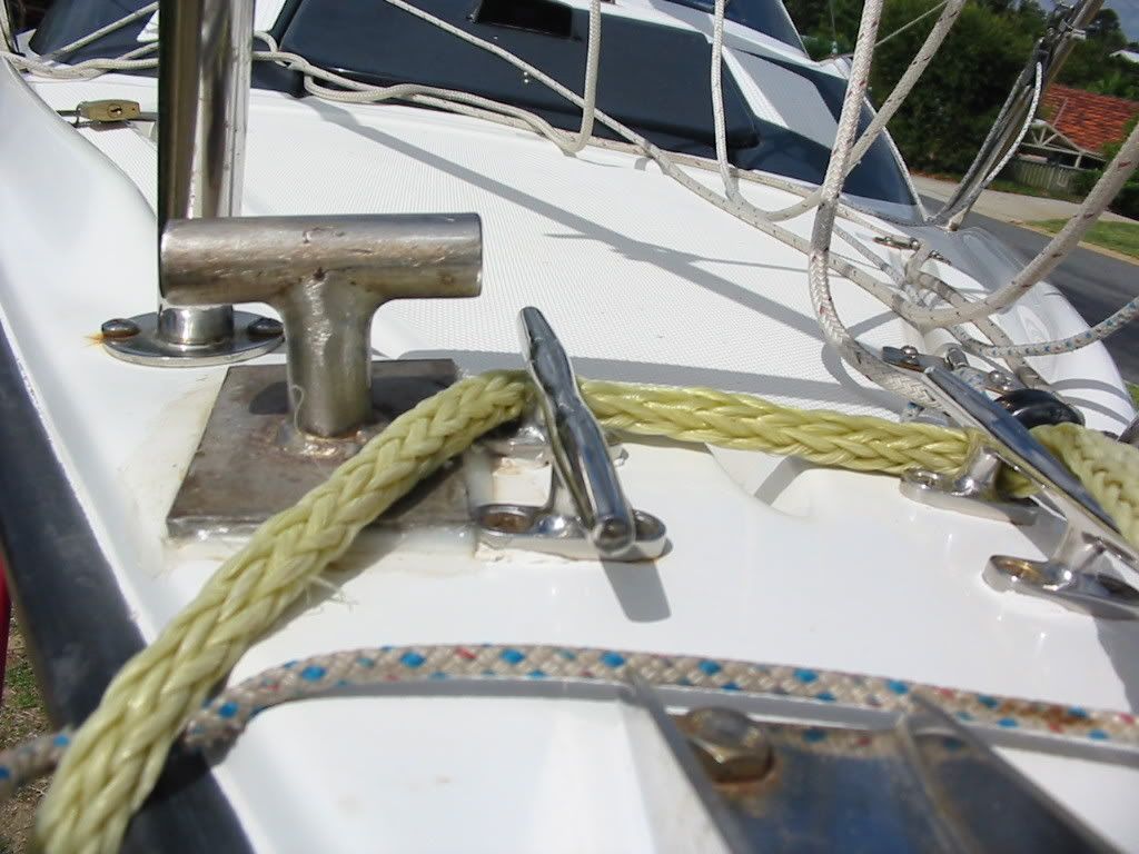

As to a strong towing point...how about this...
And even something similar in the middle of the foredeck...
My previous TANKARD [ 23 FT] had a vertical 4X4 inch solid jarrah [ timber] bollard that went from the keel , up to and through the foredeck with 4 inches over for mooring and towing...sorry, no photo ...and it got used when I ran aground in Warnbro Sound.
We all learn from our experiences...Puggsy
