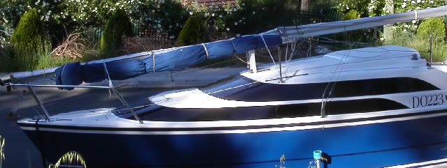

I don't know if it has been mentioned but I use "Penatrol". It brings the black color on the deck back fast. From Home Depot, about $6 a pint. Just wipe on and thats it, the black looks brand new again.
albion
Posts: 280
Joined: Sun Apr 09, 2006 11:25 pm
Location: Medina Ohio 2007 Mac26M Suzuki 50hp Hull#M1494g607
Re: Any long term answers for faded black stripes?
Post by albion »
I am in the same marina as Ivanawfulitch and I can vouch for his black painted stripes. They shine great, far better than my 07M.
