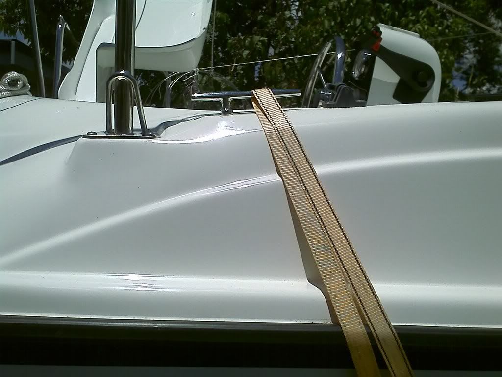

Here is what I use Image
It was recommended to me by Kevin, and I'm glad I listened to him. It wraps all the way around the boat at the forward part of the cockpit. Because of the rise at the front of the cockpit, the boat can not slide backwards if the bow breaks free from the winch.
P.S. I just took this picture a few minutes ago. It's dark out, and the flash is only good for so many feet, so please excuse the darkness of the shot. I wanted to show more clearly where I place the strap.

The type of strap I showed in my post does not leave any marks. It is a wide strap that secures very well.

I agree with your process of strapping down the boat to the trailer. We have used this process in trailering over 900 miles without an issue, plus it makes me feel good :) .
