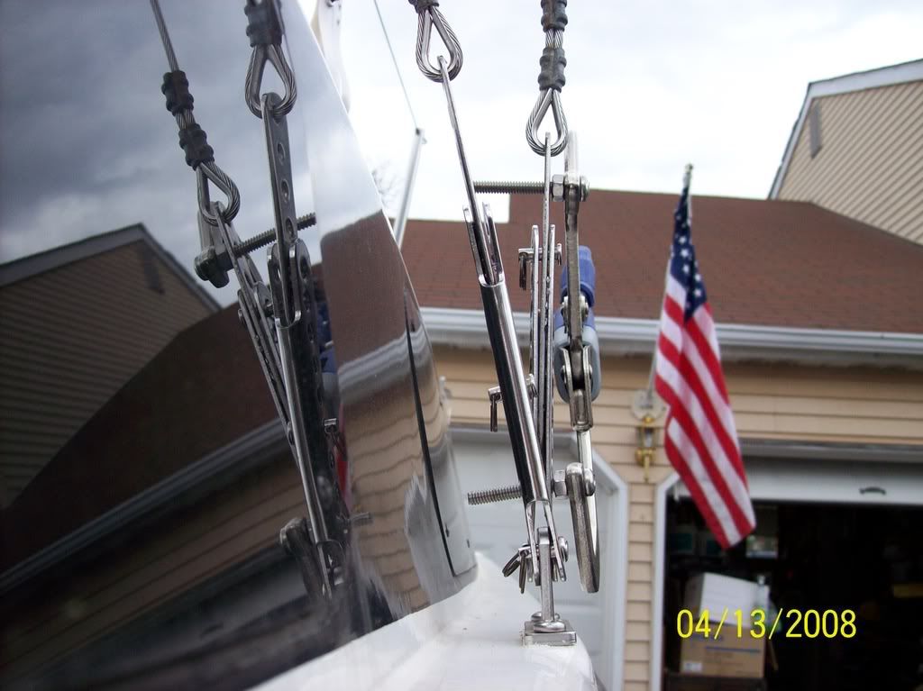

I must give Bill at Boats 4 Sail credit for this. When we picked our boat up 18 months ago he showed me something he was making to adjust the shrouds on the boat. Since I have not seen this anywhere I will assume that he will not be marketing the idea.
I went out and picked up Vice Grip clamping pliers for about $25 last year and a couple of drill bits to make this device... after a year and about 10+ drill bits I still did not have it made yet (I could not drill through the hardened steel!) I have one hole partially through and the second hole halfway. I went out today to Lowes to buy some more drill bits to finish my project. When I walked over to tools I saw KOBALT locking pliars for $15. These were different... the ends had pop rivited base plates on the jaws. When I looked at it I figured I can easily grind the rivets off and use the existing holes to put my bolts through. 10 minutes after I was home it was made!! The rivets came off easily and it worked perfectly it is a handy tool when short-handed or if you are all thumbs....
It will hold the stays uder tension as you slide the clevis pin in

This looks just like the ticket!
Simple to modify, simple to use, and inexpensive.
I now adjust my rig using the mast raising pole. More steps involved, but also effective in a slower way. Also maybe somewhat slightly safer, considering the rigging tensions involved.
Install the mast raiser. Unpin the forestay, lower the mast a turn or two on the mast raising winch to take the strain off the stays, reposition the stay adjusters, re-raise the couple of turns, re-pin the forestay, then evaluate the results.

That is a cool tool.
When I was at BWY they had a simple tool for this purpose. They sell them but I don't think they are really looking to market it. Cheryl said they are easy to make yourself.
It's a stick with 2 bolts like the the bolts in your tool.
Take a strong piece of wood about 12-18" long, drill 2 holes and put the bolts through on end. Bolt spacing a few inches apart.
Now you can insert one bolt into a shroud and the other into the shroud you want to adjust. Pull down on the stick to relieve the tension and you can remove the pin and put it in the new hole. The stick provide leverage.
VERY Simple tool.

Matt:
I've just built one to your spec and she works like a hot dam.
I purchased 2 Stamasters for my lower shrouds but I used it for the uppers. No complaints at all. With tax, the grips were 18 bucks and the bolts were out of my tool box. I used lock nuts on the ends after insertion to prevent the two parts of the adjuster from taking off.

KH sells the vice grip with the screws already in. More or less the same thing as above.

Posts: 8303
Re: Tool for adjusting shrounds under $20
Here's the simple tool
