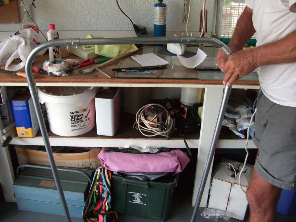

I have a similar concern - there is one bridge in the way I frequently go which causes a problem at high tide. With the X I just mounted a support bracket to the side of the pedestal pole, about 2 inches from the top and that was always good. Just before the bridge I just lifted the mast with one hand while steering, put it on that "sidemount" and after clearing the bridge the mast went straight back to its normal position.

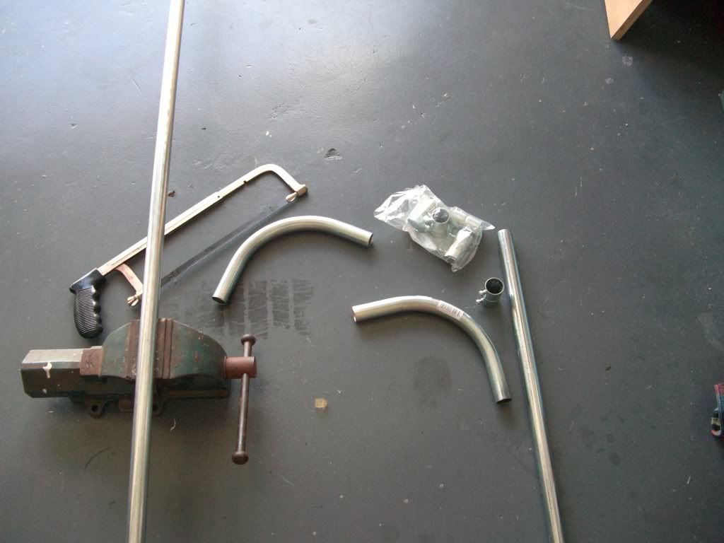

With the M I have to find a new solution, I hate to cut the arch shorter. What I most probable do is to built a temporary (shorter) arch out of galvanized tubing to see how it works. 10' tubingx 1inch = 3.87$ + 2 elbows =5$ + 2 connectors 3$ - I think that is well invested before cutting the original.

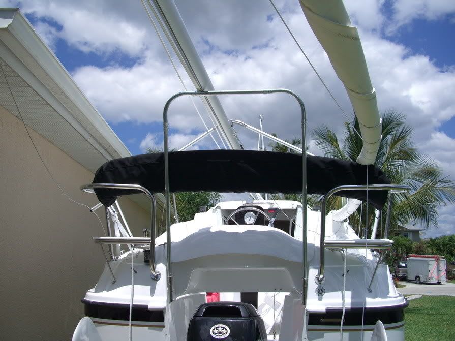

Done - and it looks good, will post pictures later today. 14.95$ total and about 1hr of work. Mast sits now really low on the boat, I guess even lower than on my X!

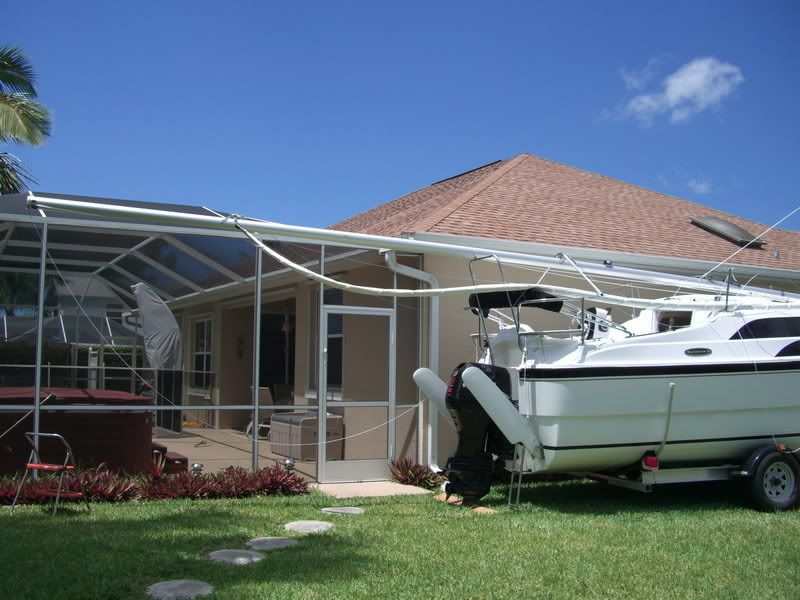

Here are pictures:
