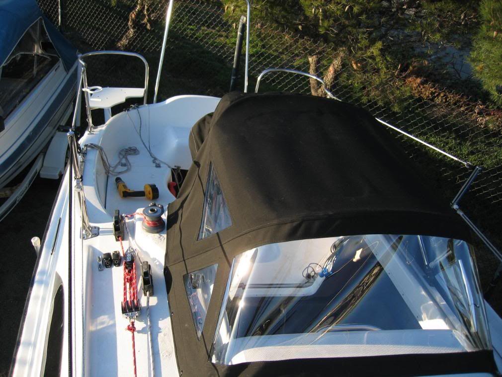

Well my baby dodger from BWY has arrived and I installed it on the boat yesterday. I think I'm going to like it. Tomorrow I go sailing and see if it passes the Delevi test. 8)

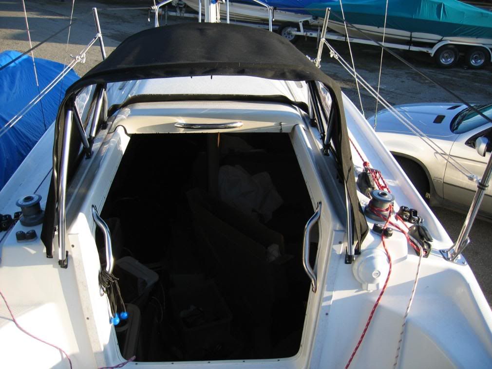

Nice job, I'm inspired by your efforts. Now, will it be the dodger or the rail seats. I guess I'll break open the piggy bank!!!
The handles in the companionway, do they hurt when you heel over or get in the way. They look really nice, where'd ya get them??

The handles were a dealer-installed goodie. No idea where they came from. I gues it was one of the options I selected when buying the boat. I never even considered them to be an obstruction of any sort. Quite handy, actually. :wink: I would imagine that BWY would have them or something similar available.

Looks nice Leon. Do you leave it on when the boat is out of the water?
delevi
Posts: 2184
Post by delevi »
Daniel,
I did leave it on after the original install. The birds crapped all over it :x so now I dont. I ordered 6 quick pins from BWY @ $3 each vs. $12 at West marine. Also got a nice helm seat cushion with snaps. Anyhow, I now remove it. It's quite easy and fast. Pull all 6 pins, unsnap, fold and down into the cabin. About 3 minutes. This also allows me to quickly drop the dodger while under sail (pulling 4 pins instead of 6) thus leaving the mid frame attached. This allows the dodger to be folded forward, yet still on the boat... haven't tried yet under sail. The reason for this is back to my original complaint of hard sheeting. The boom just won't clear the dodger. After looking at how low the boom comes down with a lot of force on the sheet (when conditions warrant really flattening the sail and heading up to the pinch zone) I don't believe any dodger would be low enough for the boom to clear and still be functional.... so in that scenario, I would drop the dodger. If anyone else has different input with another dodger, say Dowsar, I would be interested to know.
The dodger did pass some important early tests. Keeps all water out of the cabin with the hatch open. Kept me completely dry when motoring in chop (lots of spray) as I had the boat on autopilot, standing on the steps below the doger, keeping a lookout and staying dry. Still had plenty of reach to the throttle and AP control pad.
