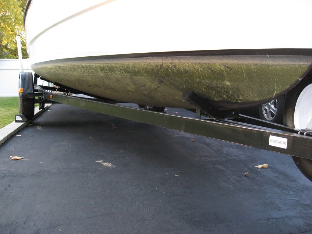

This is my first boat in the water. I did the bottom paint on it this year. I referred to my best friend who has owned a boat all his life and he told me to definitly go to the stripe. Otherwise he said that if you stop short of the stripe it will discolor and you will be unhappy. I took his advice and I am glad I did. I posted the pics of before and after.... this is in freshwater East coast full ballast. In water about 6 months before and after pressure washing. (You can see the scum line under the stripe)
FYI........I do believe I lost at least 1 mph with paint but I'm a cruiser not a racer.........I hope this helps.

The major variables are probably the angle and length of the ramp you're using [and the height of the tide at pull-out time]. I just snapped this photo of the starboard side of the bow -- as you can see, Blue Heaven has a grey epoxy barrier coat under her black Micron Extra antifouling paint.
In Matt19020's photos [above], it appears that his bow bunk merely cleaned the gunk off the surface of the paint - so it would be interesting to know what kind of paint it is.
