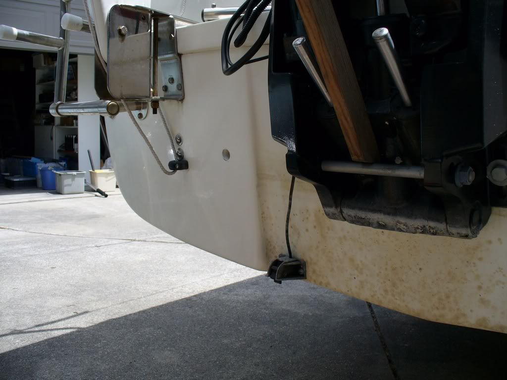

See my problem? Various chemicals worked, but req'd lots of scrubbing after the yellow-brown grunge has had time to dry.

My problem happened over about 3 weeks in the Bay. The trailer sat at my welders shop for some upgrades after installing disc brakes & 15" wheels. I should have pressure washed as soon as I pulled the boat, but time was short. After a week, it's stuck on there like ... like stucco~!
I used a weak hydrochloric solution (basically a weaker version of Muriatic acid) and it worked in some places, as shown on port transom. Other places seemed it had no effect. I'll report back after trying the SlimyGrimy.
