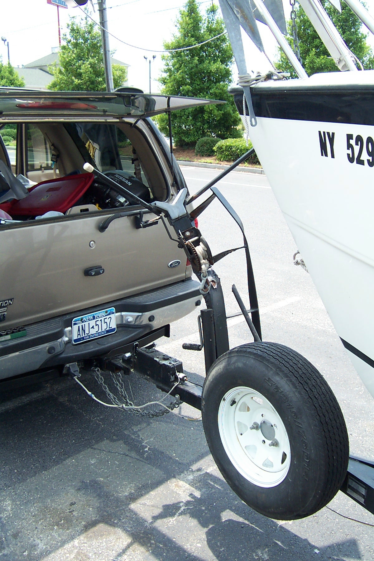

I ended up with a much heavier duty winch and strap than stock, and I still can't winch the boat all the way forward on level ground. The Mac bump is the way to go.
Note in the photo as well, how far back the boat is from the winch post. I was able to do the Mac bump in reverse to get it situated properly on the trailer.
