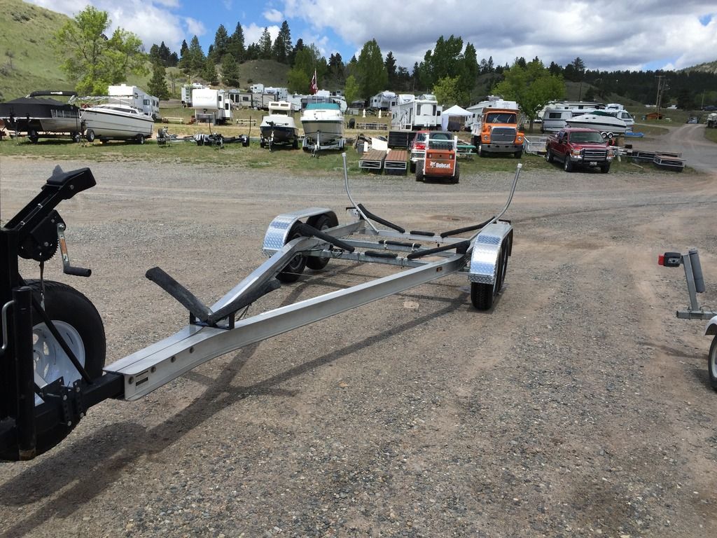

Here's a thread I started when I did mine. It's an easy mod. Even I could do it myself.
http://www.macgregorsailors.com/forum/v ... 11&t=21751
I did center the 2 axles on the previous location. Moved the existing one 16" forward and added the second 16" back from where the original was. Seems to be well balanced.

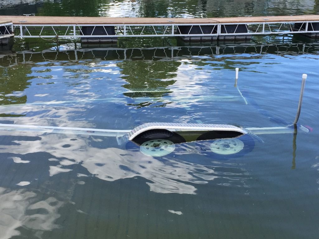

One thing that struck me odd was with a second axle, my trailer now floats.

Ditto Russ....They will actually float sideways with a current. Or at least mine doesRussMT wrote:I'm assuming the aluminum trailer axle.
