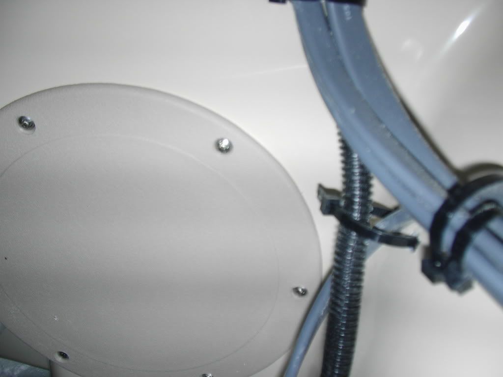

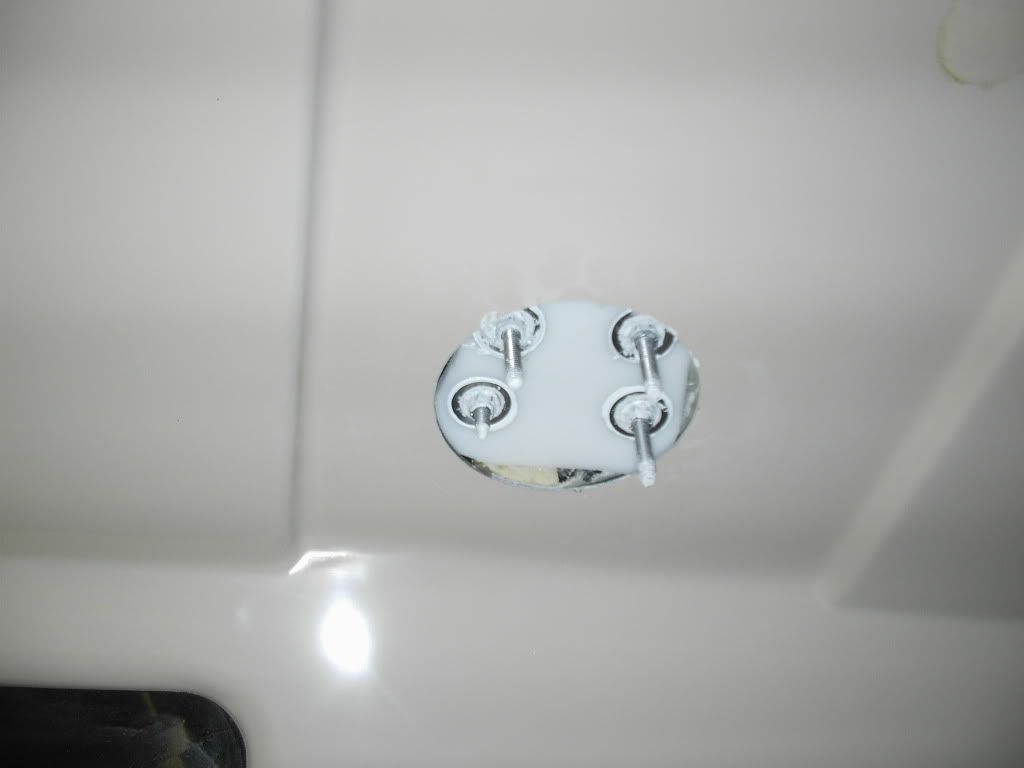

To cover any interior holes u can buy these screw on deck plates in the exact same tan colour as ur interior liner I bought them in 6-8-10"
http://i235.photobucket.com/albums/ee20 ... 0044-1.jpg
great for covering up holes like these
http://i844.photobucket.com/albums/ab1/ ... 10/016.jpg

anyway they match the liner & r great for access points inside the boat
