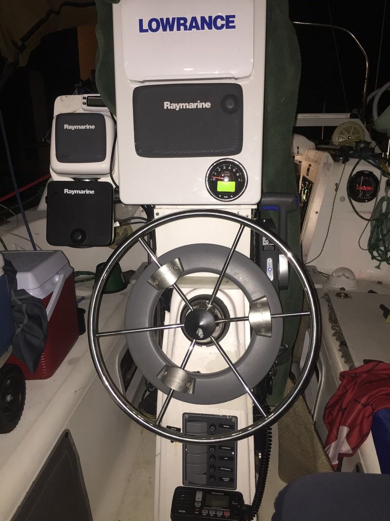

I was in the process of switching over from Raymarine to Lowrance, mainly for broadband radar capability & now Raymarine came out with their own broadband called Quantum Wireless Chirp Radar
My other holdover issue is my Raymarine Auto pilot - which isn't even working right now. So my "fix was to keep my Raym E7d MFD as a backup chart plotter & autopilot interface & wire in the new lowrance MFD. Get the largest & newest screen you can house- pay for it later or over time. Bigger is better for radar & multiple screens. My Lowrance is a 9" vs 7" RayM...
I actually took a wide horizontal box & mounted it vertically to make it fit on top of my pedestal
PS: Buttons are better in rain/ wet than flatscreen - get the mix capability
