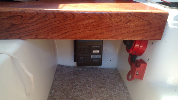

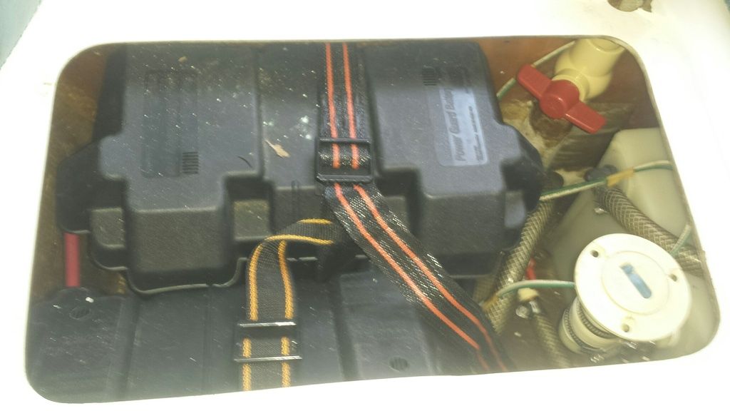

I have my two batteries forward under the left hatch in the bow berth. The switch and charger are under the seat abaft the galley. I like this arrangement because the switching is near the hatch so I can conveniently check the status of the electrical system as I depart the boat and the weight of the batteries are forward where they help with getting on plane.

Here are some pics of my battery placement in the forward V berth port side and the control switch and charger in the compartment just aft the galley on the port side. the cables run just inside the ballast tank ridge on the port side. I especially like having a battery meter that plugs into a 12 volt receptacle---what we used to call a cigarette lighter! :P Hope this helps; it may take multiple posts to get in the relevant pics. Enjoyed a rum and coke followed by shrimp alfredo at my favorite restaurant near the marina. 8)
