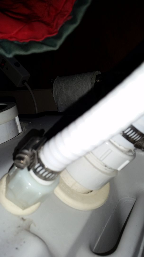

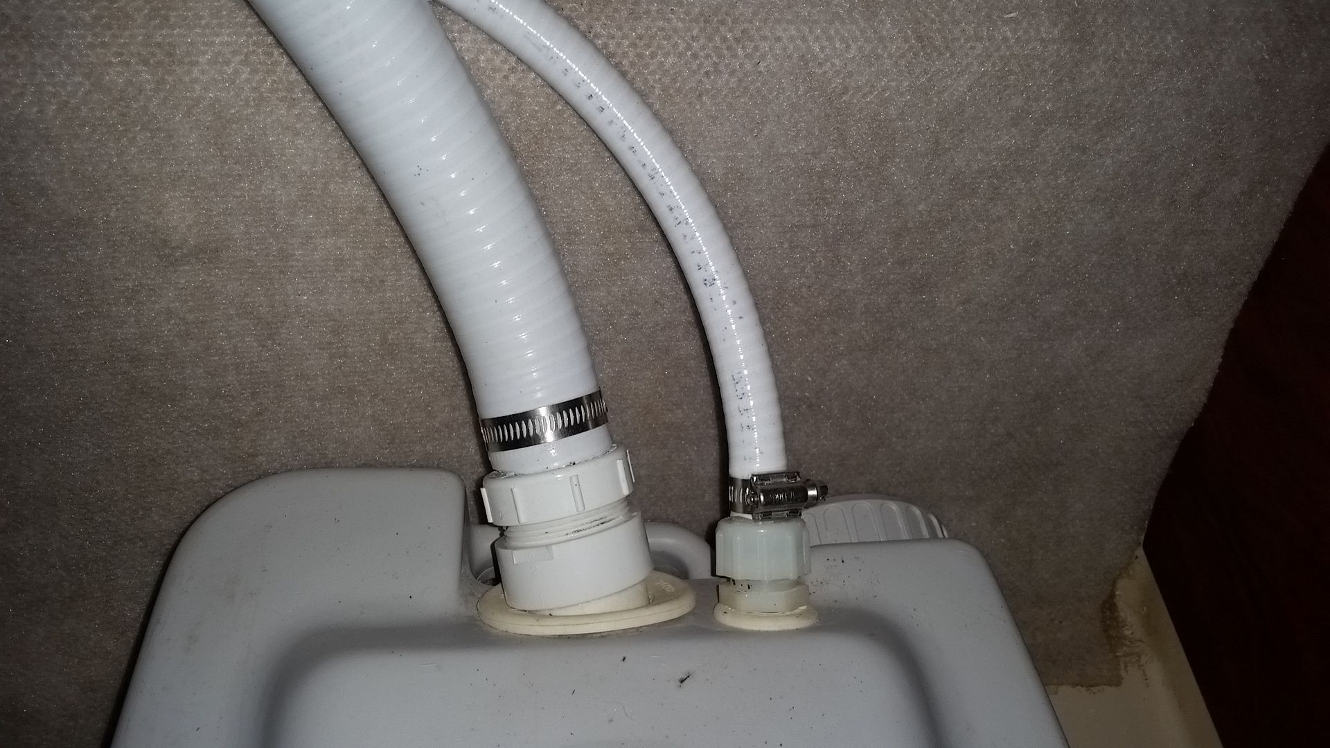

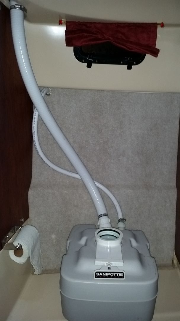

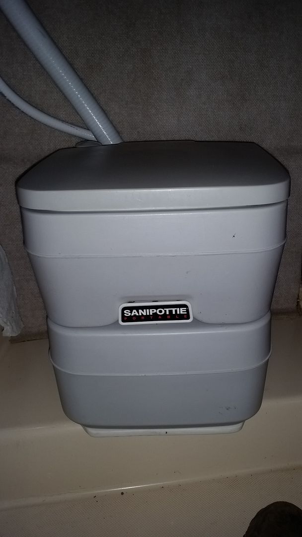

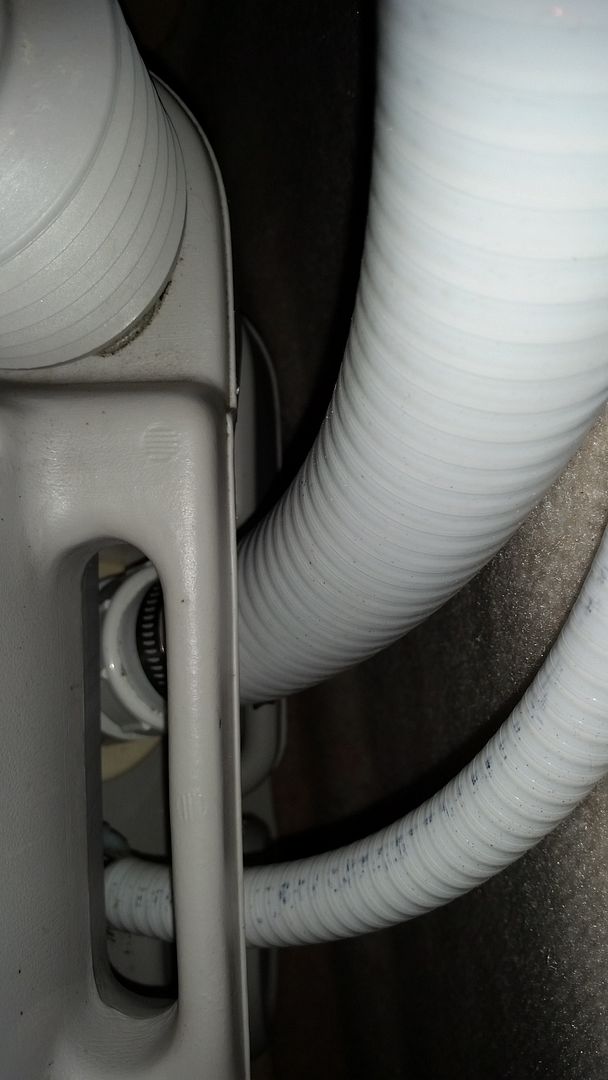

OIt's no actually a modification, as that unit was configured for pump out and vent from the factory. You're just missing the little spigots for the two hoses. But a quick check of parts sites doesn't show those parts as separate items.NiceAft wrote:Has anyone made this modification? From my observations, it seems that it is doable.
Ray I believe I,ve got the same one & the top section is off right now as I drained out the top fresh water tank in the fall & I do not think it is back on so if I get a chance tomorrow morn I will take pic,s of the bottom section & my installation

Highlander wrote:Ray I believe I,ve got the same one & the top section is off right now as I drained out the top fresh water tank in the fall & I do not think it is back on so if I get a chance tomorrow morn I will take pic,s of the bottom section & my installation
