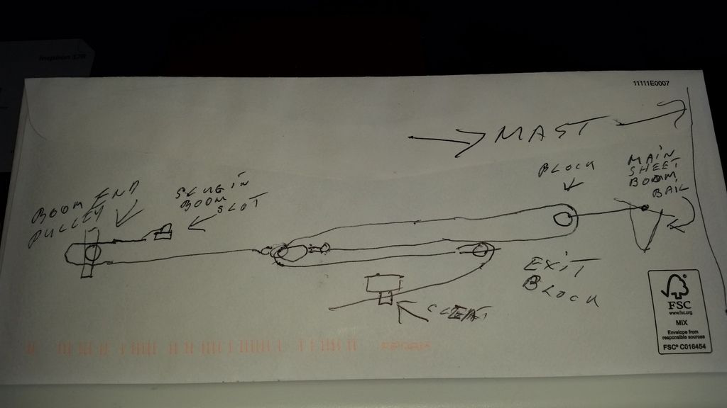

You will want a 3 to 1 so you can increase the tension while the sail is powered up. I converted mine to a 3 to 1 and made it internal. I will look to see if I have any pics.

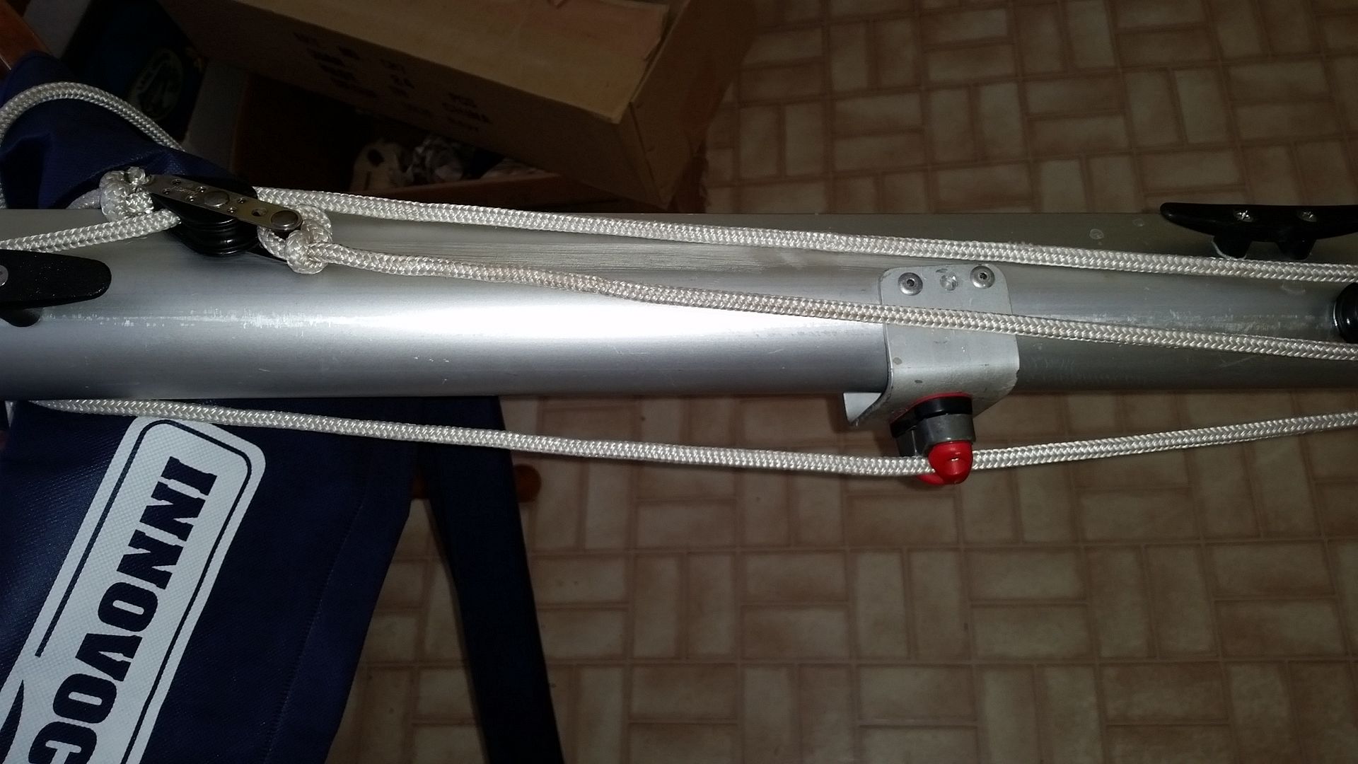

Ok could not find any pictures so I tried to remember what I did and draw it. I acually have 4 to 1. This is basically what I did. I used the bolts for the bail and vang for attachments.
Re: A mainsail question...
converted my mac main sail to a loose foot & added an internal outhaul & a extra reef
http://i844.photobucket.com/albums/ab1/ ... b13064.jpg
http://i235.photobucket.com/albums/ee20 ... 010113.jpg

very nice instructional pictures and vids. It's very clear how you did that.
Where did you get the aluminum C bracket that the cam cleat was attached to? Did you fabricate that or buy one?

Hi D.

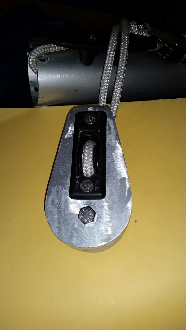

that cam cleat brkt I made from 2" alum flat bar I bought @ home depot just heated it with a propane torch in the vise & slowly bend into shape , u will notice that the brkt is on a slight angle downwards @ the rear to accommodate room so as u do not bang ur knuckles on the boom when cleating the outhaul

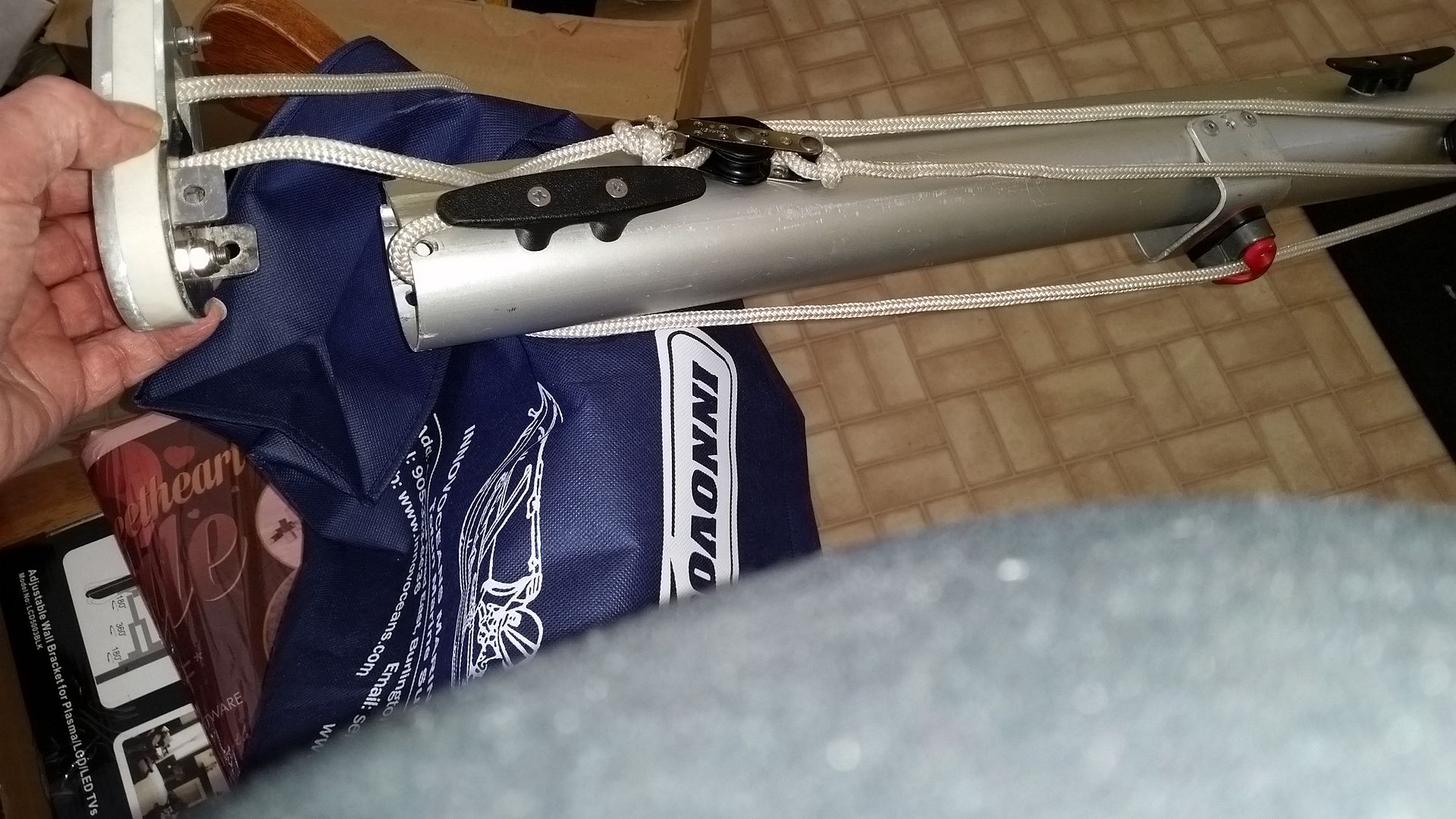

I went out into my shop yesterday -30C Brrrr darn cold brought my boom into the house so as I could dismantle it & take some more pic,s for u "do not be jumpin all over these comments guy,s " :D :D :D

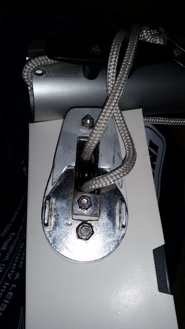

this was the original end plate brkt
http://i844.photobucket.com/albums/ab1/ ... 6c3a3b.jpg

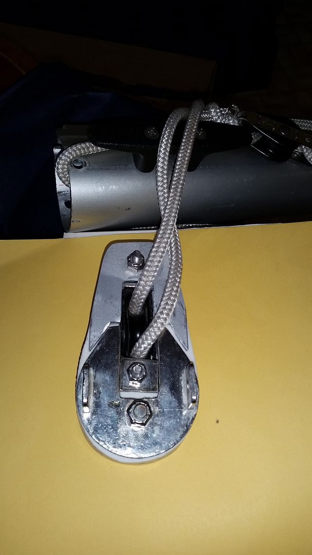

u will notice I changed it to a more pear shape wider for more strength
http://i844.photobucket.com/albums/ab1/ ... 29jbyo.jpg

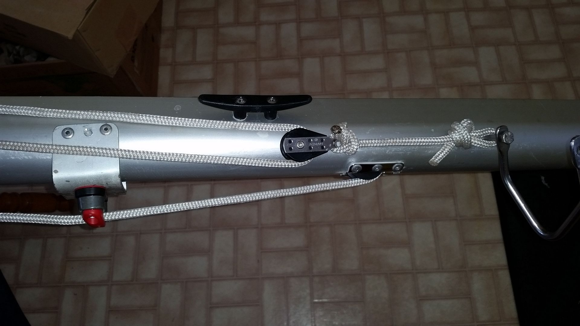

inside view
http://i844.photobucket.com/albums/ab1/ ... zzwvsq.jpg

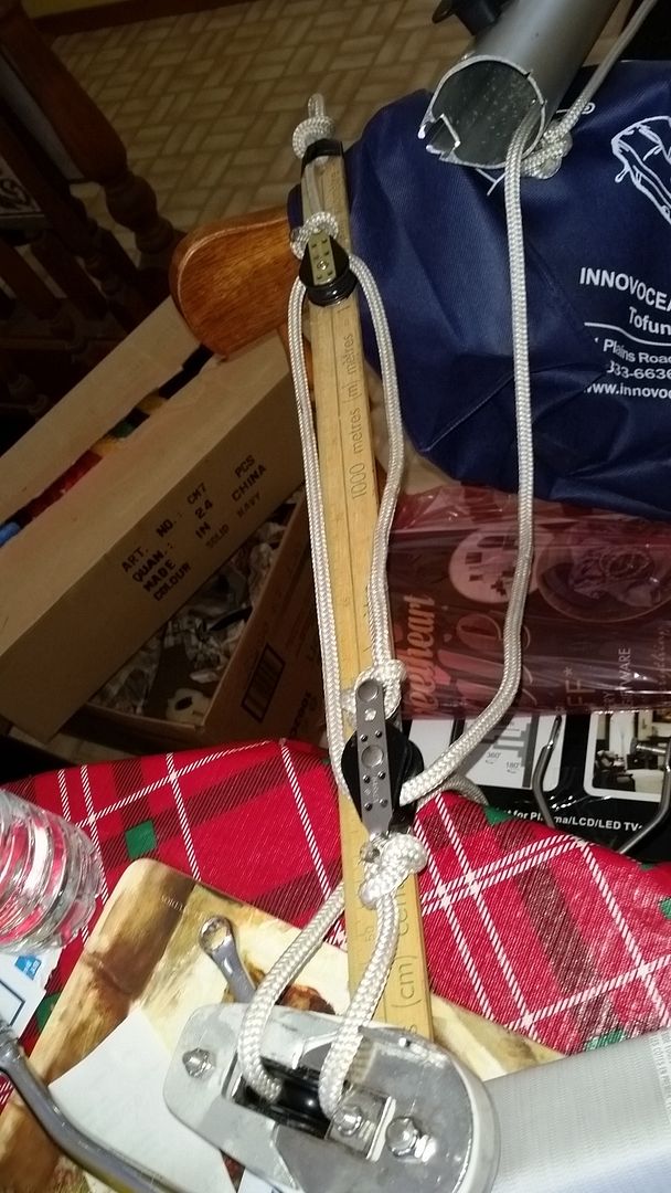

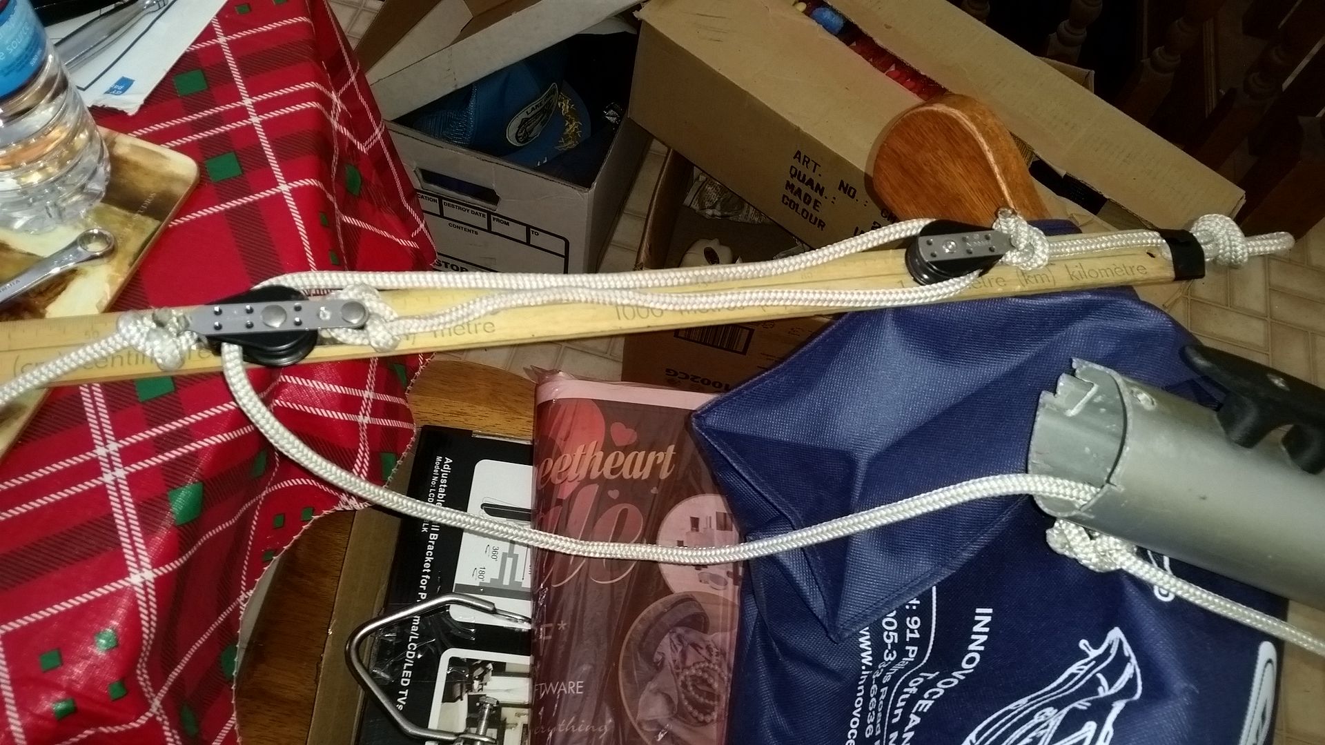

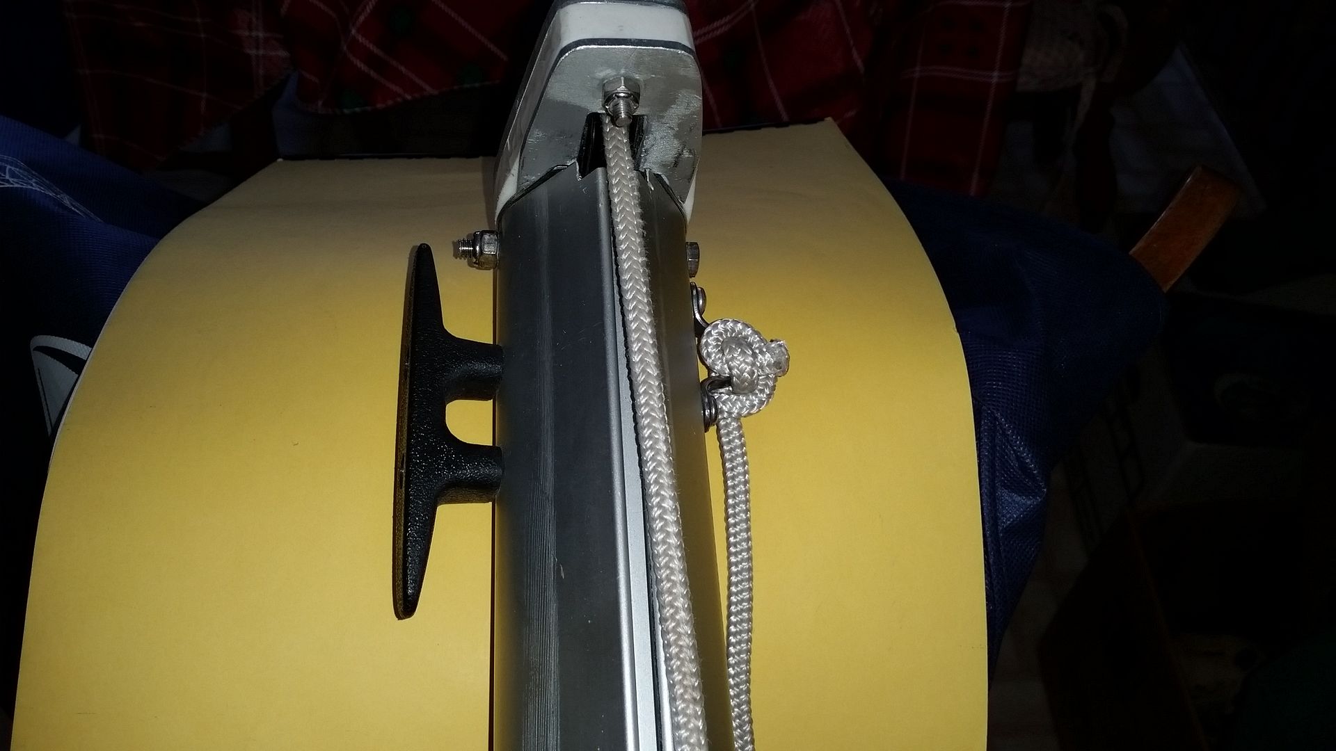

here,s how u load it inside the boom so as it does not get twisted out of alignment
http://i844.photobucket.com/albums/ab1/ ... lfljwt.jpg
http://i844.photobucket.com/albums/ab1/ ... s70hf6.jpg
http://i844.photobucket.com/albums/ab1/ ... 5grlhx.jpg
http://i844.photobucket.com/albums/ab1/ ... i0hygn.jpg
http://i844.photobucket.com/albums/ab1/ ... innqcq.jpg
http://i844.photobucket.com/albums/ab1/ ... wxo3nm.jpg
http://i844.photobucket.com/albums/ab1/ ... kkhr5r.jpg

In my design no problem as the original outhaul is still in place for reefing purposes
http://i844.photobucket.com/albums/ab1/ ... di1bnd.jpg
