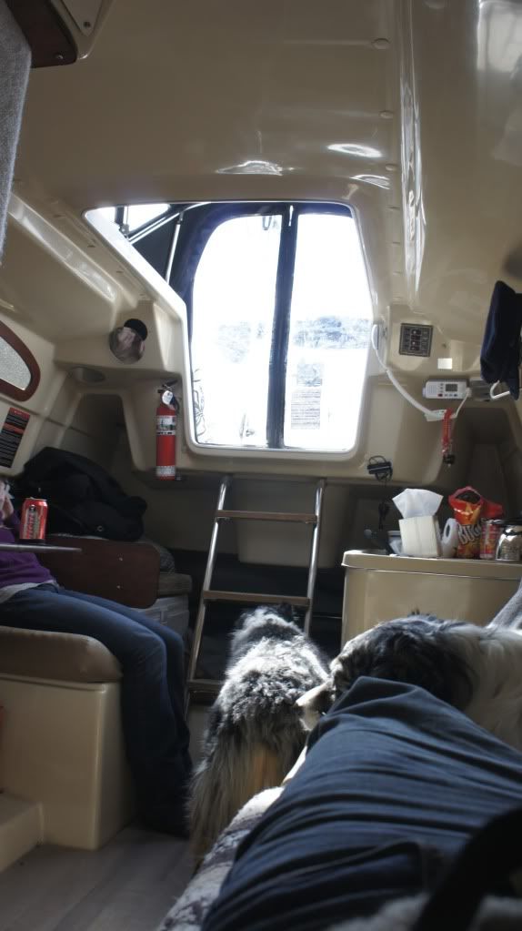

Here's an overcast miserable day (pre full enclosure) with the dodger and doors in and open. Plenty warm inside with lots more light. Only catch is you have to close the companion way if under way (if its cooler like here) or the warm moist air from inside will fog up the 'glass'. I will try Russ's rainx this year maybe.
Doug W
Posts: 632
Re: question on dodgers....
Post by Doug W »
Wow! That view from inside the cabin really visually opens up the cabin!
