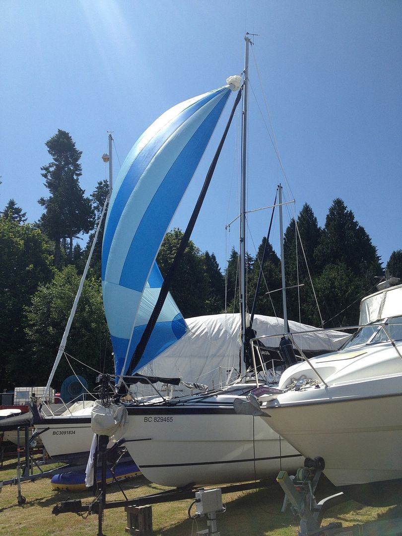

We have all three types of spinnakers with separate Chute-Scoops (photos below).
Our Gennaker: (can point a little higher than a our Asymmetrical, basically a similar cut (shape & draft) as the our dacron 150% genoa)
Our more balloony Asymmetrical
Our strictly downwind Symmetrical (with pole to starboard, you can see the topping lift bridles black line)
