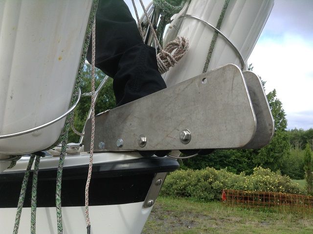

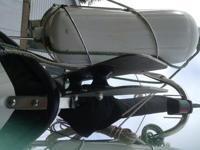

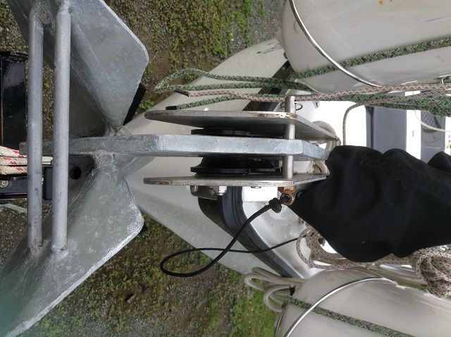

i made an anchor holder- bigger than the standard mac one- two pieces of s/s bolted either side of the existing roller, with extra rollers in it- holds my 22 lb plough anchor, and it has a pin through the plates and the anchor stock that keeps it all in place- will get a photo up today. i know other folk who have bought an after market anchor roller- and bolted it on- same deal

i know you said stock roller- but here is what i did anyway- if that helps you mate.
i pin the anchor, and chain into the anchor locker- never moves.
at the back of my bracket you can see a small to plate welded on- that retains the back of the stock
cheers
