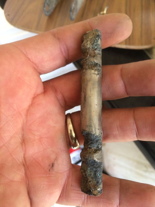

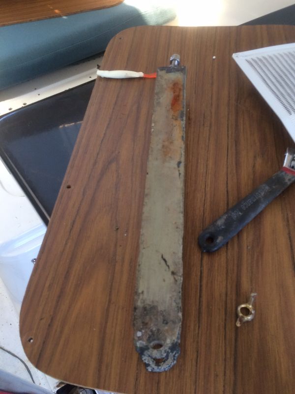

Wow billy that's genious. I just banged & pressed mine out of the way. While the hangar is still useable my bolt/dowel galvaniclly corroded :P

I'm going to barrier coat my new one & trilux bottom coat for metal my new one so it won't get like this one:
Also screw the nut to very top to protect the starting threads if banging.
