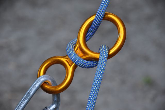

I use a climbing figure of eight like the picture. Works well and cost $10.
Line from the stantion base to the boom to stantion base block and back to spare locking cleat by the winch.
