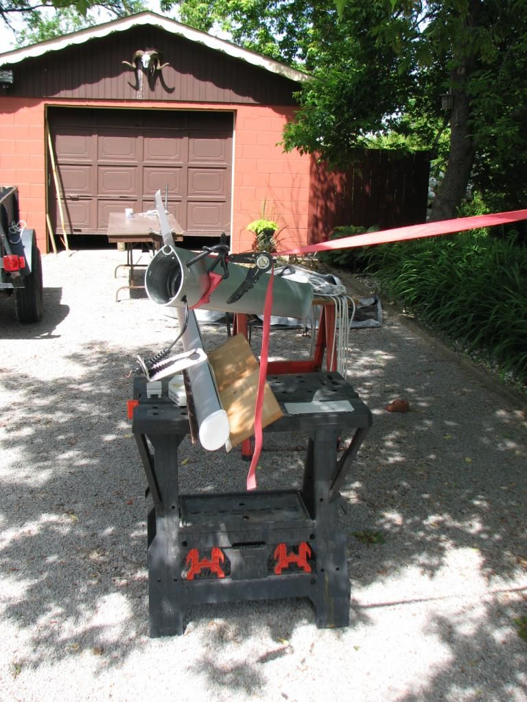

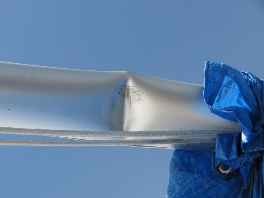

Can anyone supply me with the measurement of the topmost mast-hound bolt location? I have a severe bend in the mast tip and I am uncertain whether the distance from the top (minus the cap) is: 6ft, 6'1/4" or 6'1/2" to the center of the bolt hole. That little difference probably wouldn't make much of a change in the roller furling rigging but I thought I'd try for some feedback before drilling the new extrusion.

I tried to put some muscle into it, to straighten it but it wouldn't budge. Just for the heck of it I'll compare the overall length of the mast's, including the extra radius of the bent one and see how things stack up with any noticeable variance between the two. As the top lives as a Bermuda rig (?) it doesn't really mean how tall the mainsail sets...

Thanks to Tom I got the brain working today and drilled the baby after measuring from the bottom up (doh!). Funny thing - on just about all the holes I've done so far I've noticed many of the original mast drillings were off by as much as 1/4" from the center line for one side. They must have had a miss-aligned jig when they put mine through.The bottom swivel plate actually had the through-bolt tangs offset from one another and if I hadn't paid attention I would have ended up very upset with my self. Measure twice!
