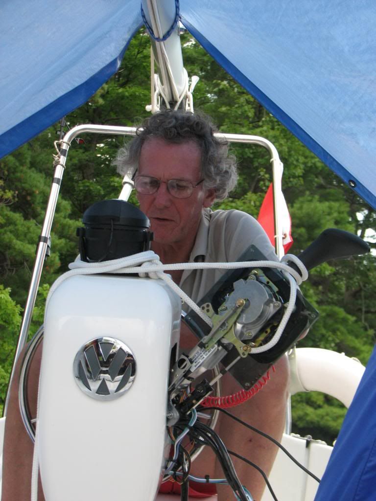

Wayne, have you taken the dark plastic cover on the side of the pedestal off? Removing the front will only reveal a layer of plywood behind. Here's me working on my throttle control. I replaced the original with a larger, stronger piece of plexiglass.

thanks Crikey, i got in!!thanks for the info- saved me some grief!

At our local Canadian Tire outlet. It was dark grey, not black like the original but half again as thick. I also opened the hole up slightly to make things fit better. Came with a plastic film to protect it from scratches during installation. I added those later... :D
I chose to do this rather than open up the other side as Highlander suggests. I'm a Molly Duka, and need to use my left hand! :(
R.
