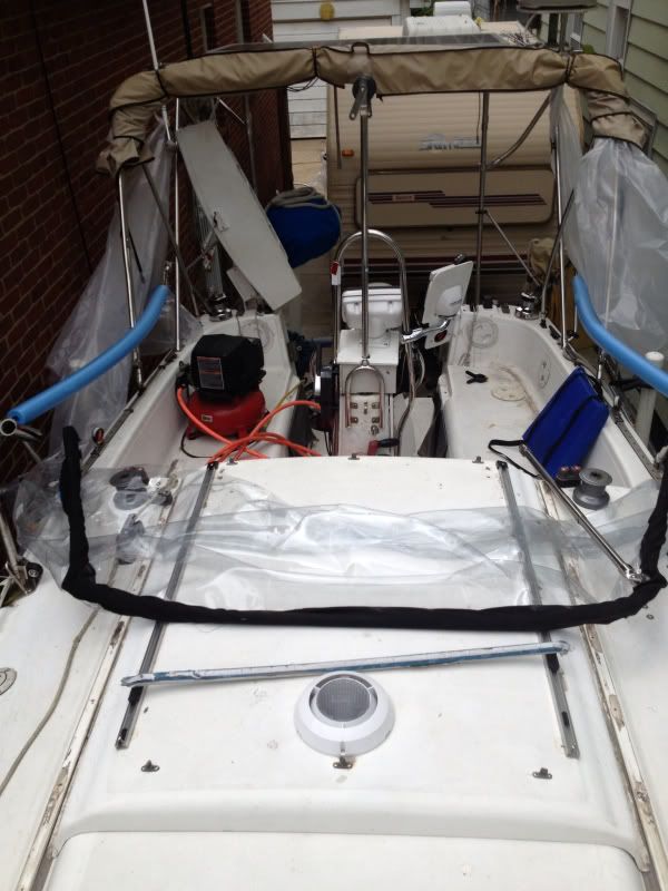

Are you sailing or just cruising? Saw your 90hp E-Tec listed. Also, is that a dodger up front over the companionway? What size fuel tanks are on board? I'm looking at 60hp E-Tec's for our 26X. Thought I would "trade-in" my 50 hp 1999 Tohatsu (3 carbs). I have two 6 gallon tanks, and at economy cruise, it should be ok?? We may end up just motor-cruising. Not sure yet. The thought of filling up and lifting two heavy 12 gallon tanks on board after refueling is too much.

Actually it's a windshield.Here's it looking proper.Image
It folds down when not needed.
It's only half sewn. Don't mind the mess, I'm in the middle of modding.

Is that a solar vent sticking out of the window (and on the companionway hatch)?
Curious if you get enough sun for good operation with it sideways, and if you like or regret putting one on the hatch vs. another location.
And lastly, did you use a hole saw to get through the plexiglass on the window (and the hatch for that matter) or something else?

I can answer one of your questions . We put a solar powered vent fan in the head and one by the dinette in our :macx:
So that is two fans in one window. I drilled thru the plexiglass and used black silicon for the installation . I drilled it with a holesaw . 5 inches , If I remember correctly .

The side ones are solar. The hatch is a passive that's plugged into the hole which the PO put a non draining dorade on the sliding hatch - Not my choice - just my solution.I had constant rain leaks with the dorade. The Solar is hanging off the stantion and catches more sun than the original I had which was in the white part of the vent. Regarding tools I use a rotozip especially the spiral saw. There's a hole kit, but I tend to freehand.
Re regrets: No. It's much easier cutting warm plexiglass than fiberglass. & if you don't like it - simply replace the plexiglass :wink:
