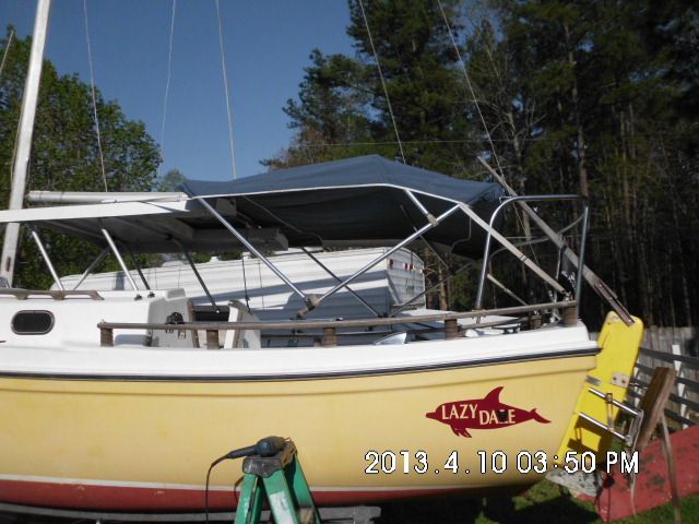

I haven't been on in awhile...but I have been working on the boat.
Those of you might remember I bought a 23Venture Newport, and then bought what we called the "S.S. Crack-boat" due to it's sorry condition and stripped the parts and scrapped the hull. Then I put my Venture on the sweet dual axle trailer and sold the other trailer.
So I have been slowly at work on the venture.
I fixed the Mast OOPS and the mast is now back up.
I fabricated and installed a Bimini top for the admiral.
I also installed the life lines, bow pulpit and stern rail I scored from the crackboat...I think they came out well.

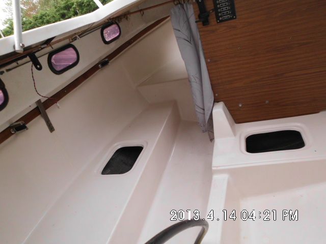

Cleaned out the interior (two bottles of tilex) and I'm still not quite done in there yet.
more pics coming next post...forum only allows 3 i think

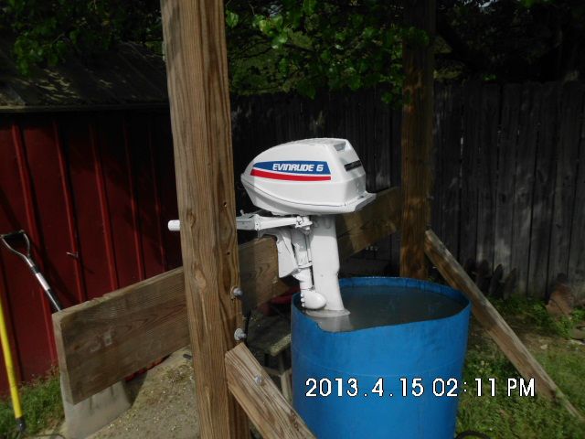

I also on advice from this forum and the venture23 group got rid of the huge 100lb 15hp and traded it even for a completely rebuilt and new condition Evinrude 6hp. The 6 has Fwd and Reverse. A bonus I noticed when I picked it up is that it DOES INDEED have hookups for forward control. And wow, what a coincidence I just happen to have a set in my "junk pile". So the Venture will have Forward controls in the cockpit so goodbye to leaning over the stern rail to adjust the motor

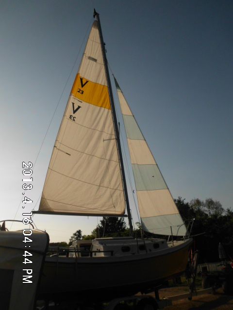

And lastly, just yesterday a friend helped me raise the sails for a photo op
Still a lot to do

Nice work!! I've always thought that those are the prettiest boats that Roger ever made,
Sum
Our MacGregor 26-S
Our Endeavour 37
Mac-Venture Links
Posts: 4969
Post by BOAT »
Wow, looks way bigger than 23 feet! looks good - like a proper sailing ship.
vizwhiz
Posts: 1388
Location: Central Florida
Post by vizwhiz »
Looks great, and good stories to boot! Will be very nice to see it sailing!

That 6 hp is much better suited to the boat than a 15. I would suggest looking for a high-thrust prop for it, though, if they make such a thing. The three-blade props with the narrow, swept blades are more for speed than thrust, and that boat won't plane, so you're limited to less than 6 knots no matter what you do.
This is a high-thrust prop for the ubiquitous 9.9/15 hp Evinrude/Johnson 2-strokes of days gone by. Big Mickey Mouse ear blades make for more thrust. I used it on a 23 footer. Big difference. Actually had reverse, too (scary trying to slow it with reverse with the original prop).
But if high-thrust isn't available, at least make sure the engine will get up to rated speed.
Actually, it looks like the Solas Amita for that engine has wide area blades. :wink:

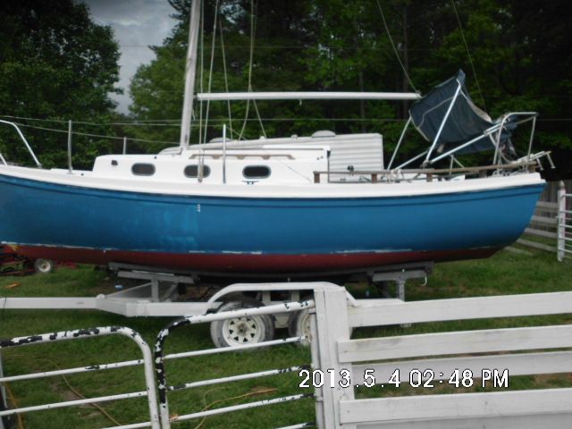

Right now I am painting the boat. After much discussion with the admiral we both decided the banana color HAD to go!
She has been sanded down and has the first coat of primer on it...now waiting for weather to co-operate to put on the 2nd coat of primer.
We originally wanted to go with a very light aqua green, but were disappointed in the color choices of Interlux Brightside paint. Only maybe 13 colors to choose from. The Admiral finally chose ocean blue and we were going to roll-n-tip it (I have done before on smaller boats in the past) and it comes out well.
However talking to a friend who paints he said he would bring his sprayer and etc over and stated there was no reason at all we couldn't use an automotive Urethane (sp?) and Hardener and get whatever color we want. So we are going for the very light green we wanted originally (similar to Carolina Skiffs we have seen around here). I think it will look Great.

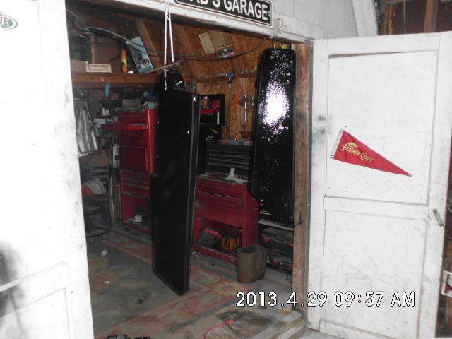

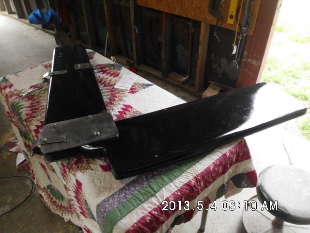

The old rudder was disassembled and stripped down. I was disappointed that it was a fiberglass with wood core, as I wanted to do a nice wood and varnish look. Instead to save $$ I stripped it down, re-glassed the nicks and dings, and went with Straight Rustoleum High Gloss Black.
The Rustoleum holds up well even under water, I have used it before. This boat stays on a trailer not in a slip so it will be fine.
The 6hp has a standard prop on it currently. After paint we will go out to falls and motor around and see how she does. I have other props from other motors, but not sure if I have one that fits the 6hp...however I can always upgrade later on. I agree a high thrust prop is a good idea to maximize the power from the motor...speed has never been a goal for us since we bought this venture. In fact the whole point was to slow down after years of antique run-abouts. Slow cruising and margaritas is where we are now.

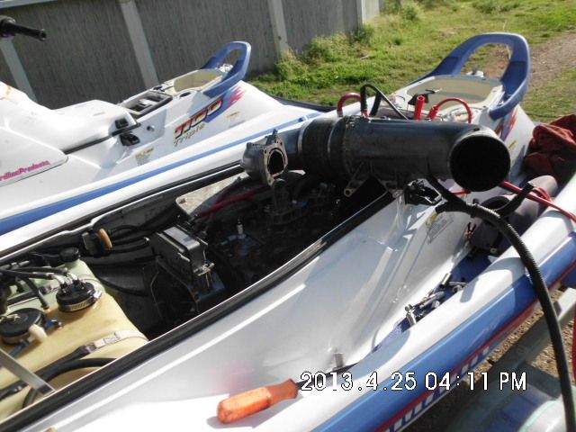

On a non sailboat related topic I had to change a corroded starter on a customer's jetski. Had to pull the whole exhaust riser out to get to it...Man I hate working on Ski's

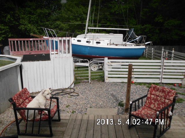

Just a sneak peek of the first coat of color....still a lot of work to do!
And the rudder is done
Cheers!

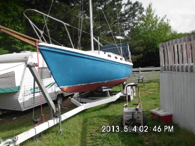

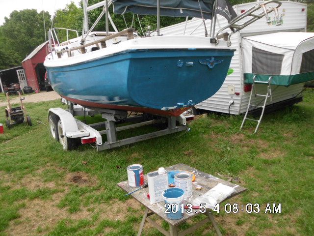

1st coat is done
so much more to do
Cheers!
oh, the mint green we wanted didn't work out....the materials were $400....roll and tip the ocean blue was $100
