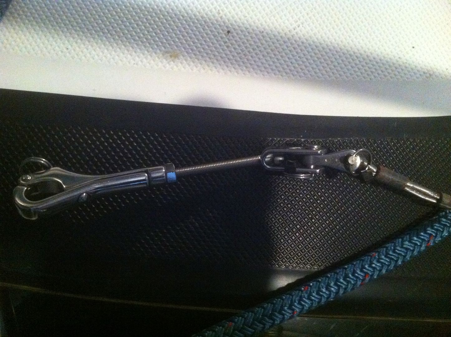

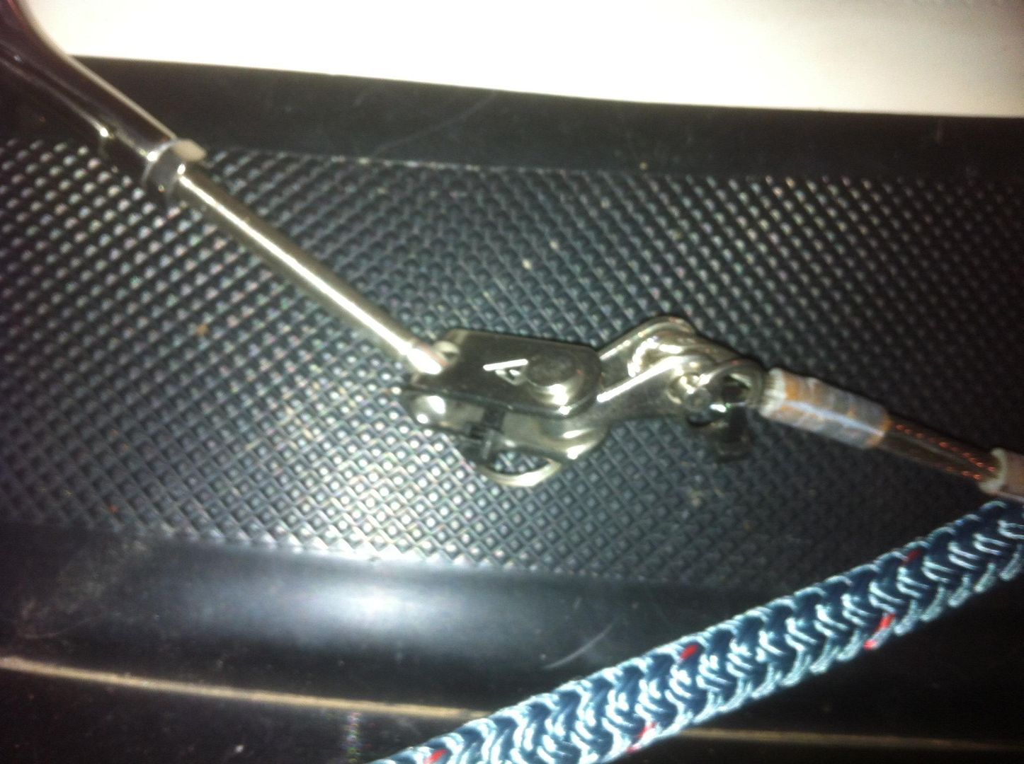

Or put pelican hooks on the lifelines so you can drop them.
Re: Please tell me about your Arches!
Here's a couple of things I have done , in this pic u can see the adjustable leg I made it lowers for towing supports the mast while towing keeps it from bouncing all over the place when going down the hi-way, raise the the leg when stepping the mast this allows u to stop the process if need if some thing should snag up & u r by urself it allows u to rest the mast right there at any position as they r now above the lifelines
Also Pelican Hooks too the front of the lifelines

I drop the lifelines to get them out of the way.
