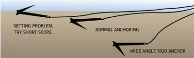

The fortress fx11 (7#) is more than enough (made for up to 32' boat). The FX37 is waaay overkill - made for a 50' boat
The trick with the fortress (and most danforth) is to set it right. In SOFT mud, remove the chain off the rode, or it won't hold well and use shorter scope
The anchor locker on an X won't hold the fx11 without modification. It will fit in an M though.

The Fortress anchors have two settings - standard and mud (angle of flukes). Earlier this year I was rafted up with 7 other boats, 6 much larger than my
when the derecio storm hit us - 90 mph winds. All boats moved but the next day, the anchor that had the most solid set was my FX-11, and we did not even have it set for the mud we were in. We were so impressed, we purchased a second FX-11.
The FX-11 will just barely fit in the anchor locker of the
. Many will dismiss the holding power of this anchor because of its wight but read the independent tests and see it blows away the competition every time.
Guess what my recommendation is

I said in soft mud (not grass) not to use a chain, as it tends to pull the shank down, and forces the flukes up like in the first pic on the left. Initial short scope til it gets buried helps as wellDaveB wrote:I have the F11 Fortress and works great in all bottom except grassy bottom. It picks up the grass and clougs the anchor so it doesn't set well.

have only dragged the fortress in grassy bottoms. other than that, its pretty bulletproof. Anchoring is technique as well as hardware. I usually have a harder time recovering it because it is buried so deep and solid. always resets well in anything other than grass.
9 out of 10 times when I see people dragging (any anchor) it is due to to short scope and not properly setting it. I try to power set at 10:1 for a minute or 2, then shorten to 7:1 Many times people forget the freeboard, which can be several feet, needs to be added to the depth as well. so 10' of water under the the bottom of the boat, is really about 16' for an X or M (bottom of boat + keel to bow roller height ). If 70' is put out in 10' (under the bottom where your depth sounder is), it is not enough for setting properly, you need at least 112' for 7:1
