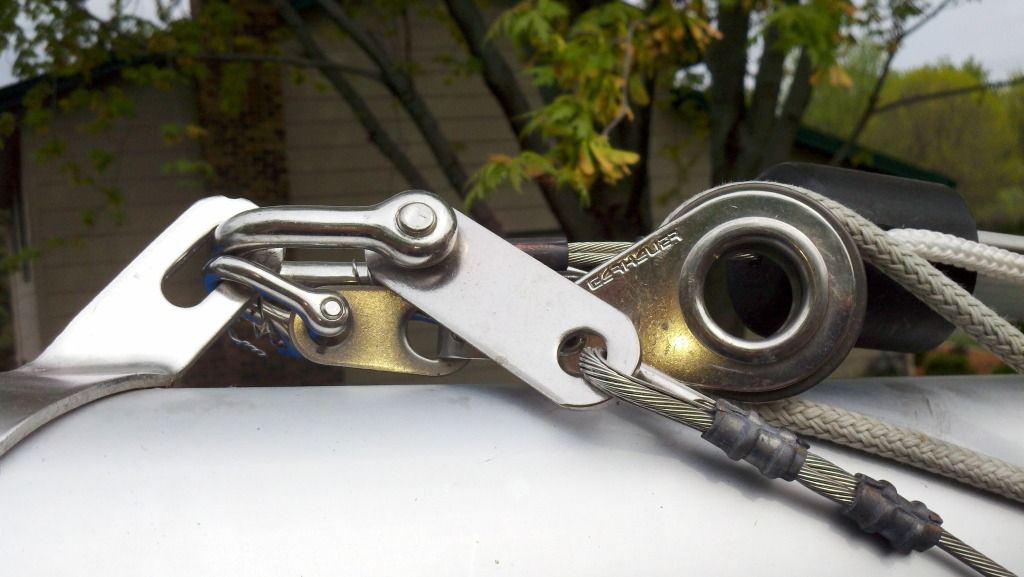

What do people do with their jib block after insalling a CDI ll furler?
The pully runs free but the block itself seems to be pinched against the mast buy the upper shrouds. No matter what I do it doesn't swivel. The set up is exactly like the picture in the manual, except with the furler. Difficult to see what's happening 25' up.

Picture of my set up.

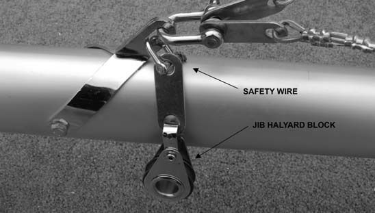

Picture from the manual.
Thanks for the replies, think I figured it out, maybe.
My original upper shrouds didn't have the extra "tang", I order new one because they were binding with the lower adjusters when raising the mast and getting nicked up pretty bad.
The new shrouds came with an extra "tang" you see in the picture. I think the tangs are pinching the block against the mast when raised. The picture from the MacGregor manual shows a longer tang between the shackle and the block which I think lets the block hang free. I will probably need to replace the shackle with a longer one to fix the problem.
For now I have just remove the jib block and halyard.

I replace the standard D shackle that comes with the boat(s) from MacGregor with a Long D shackle, on boats that I sell.
This puts the jib halyard block a little bit lower.
When raising the mast, when it is about half-way up, I pull the jib halyard up and down to make sure it is not caught under the upper shrouds.
