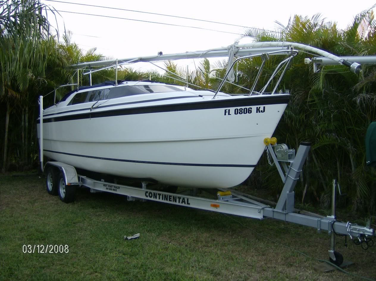

My new 2008 Aluminum Tandem trailer cost me $2900 without brakes ( I added front stainless steel disk for $500) .
You never have to bump and very easy loading and launching in 2 ft. seas with guides.
Best part is you barely know you are pulling a trailer in a V8 pickup in flat level road, in my 1999 V6 ford f150 with standard trans. Max. tow 2000 lbs I don't feel it on flat grade doing 65mph.(185 mile trips to Pennicamp FL.)
With the Auto Trans. would be no problem.
