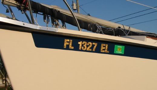

Ok my new project is starting to take shape. It will extend two feet past the bow and one foot on the bow for attachment. I am going to covered in fiberglass cloth and painted black to match the boat. I will attach it using four fasteners and bond it to the boat using Pro-Seal or possibly Hysol.
Once i get done shaping it to the bow the I am going to tapper it down to about one inch thick at the end. it will also have a cable from the end to the bow eye with a quick disconnect so I can still put it on the trailer.
